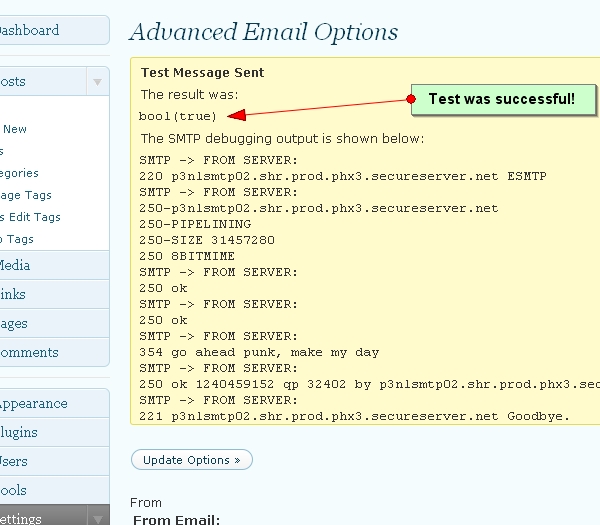

    11. If you did everything correctly, you should see the following screen:
Courtesy of Angstrey.com
