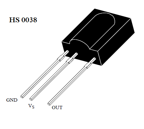

?? ????? ???? IR Receiver ??? Pin Configuration ?? ???? ??? ????? ????? sensor ??? ??? ????? ????? ?????? ??? ???? ???????? ??????? ????? ???????? ?????.

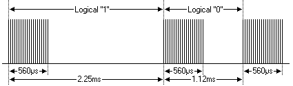

??????? Modulation
PROTOCOL ??? ?? logical 1 ??????? ?????? 560?S ??? AGC Pulse ???? ?? 1690?S ??? Space ??????. ? ??????? logical 1 ??????? ????? 2.25ms bit time ???? ???.
Logical 0 ??????? ?????? 560?S ??? AGC Pulse ???? ?? 560?S ??? Space ??????. ?????? 1.12ms ??.

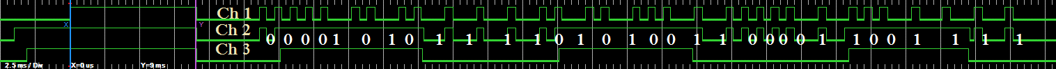

?? ????????? Ch2 ?? Ch3 ???? ???.

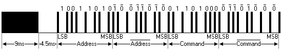

?? ????? ?????? 9 ms ??? AGC Pulse ???? ?? 4.5ms ??? Space ???? ???? ?????? ? ??????.
???? address ???? command ???? ????. ???? /(address ) ?? /( command) ???? ?????????? ???? ?? ????? ????? address ????? command ????? (Complement) ???????? ??. ?? ???? ????? ??????? Tx ???? ????. ??? ???? ???? ????????????. ????? ?????? ?????????? ??????? ???? ??? ???? ?????????. ( SIRC ????? ????? ???????? ??????? ????? ??) .

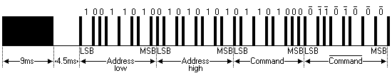

address ???? command 8 bit ??????? ???????. ? ??????? ??????? ????? ??????- combinations 255?? (0-28-1) ?? ??????? ??????? ???? ????. ? 255 ?????? ???? ?? Invert ???? byte ???? ????? 16bit protocol ?????? ????? Extended Protocol ????. ????? 256 ?????? 65535?? ????? ??????? ?????????. ? ??? ?????? ?????? ?? ??.
