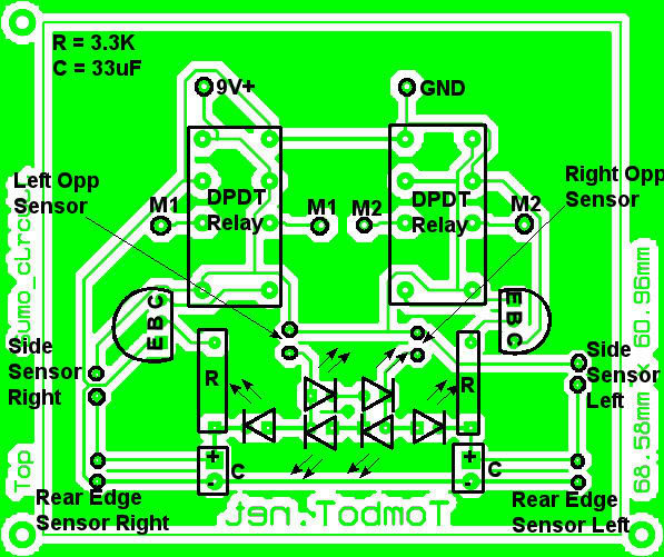

  1. The 1st thing to do is to make the PCB layout either by using the eagle cad or by using EXPRESSPCB software...these software are easily available and tutorials are available to help u make such a layout......
  2. Now take a printout of the layout in a semi gloss paper.

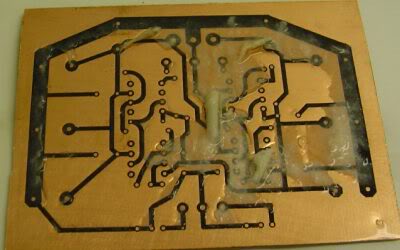

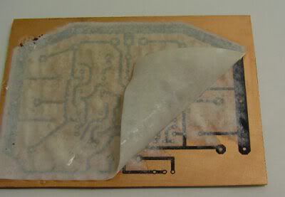

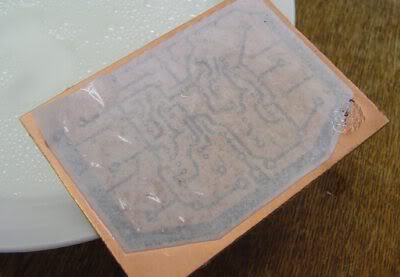

  3. Now take the printout and cut out the design ... place this Design on the copper clad board ..face down..Take a heating iron and heat the paper along with the board so that the paper is completely stuck with the board...give good pressure and leave no gaps...

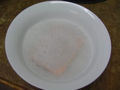

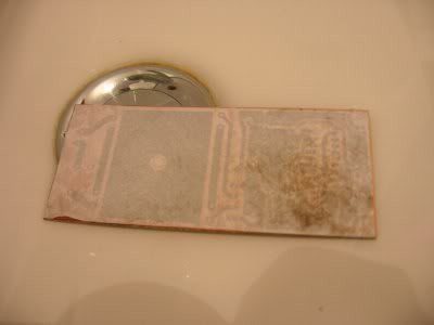

  4. Take this board with the design stuck to it and soak it in soap water for some time so that the paper becomes soft and can be easily removed

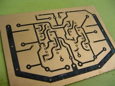

  5. Then CAREFULLY remove the paper. Be sure not to remove any of the black ink traces because these are what stops the acid in the etching process. Use a kind of rubbing motion to remove the paper. Keep it wet all the time so that it separates easily from the copper board.

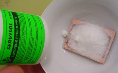

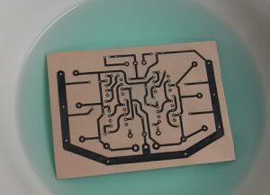

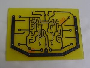

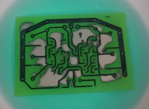

  6. The pcb is done and ready for etching now....use an etchant and follow the normal dilution level given...use a glass or a ceramic bowl...do not use copper or iron bowls.

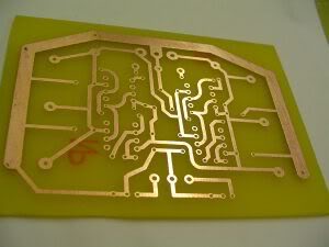

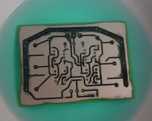

  7. Dilute the etchant with boiling water and place the pcb inside it..And slowly swirl or rock the bowl around. The liquid must be always moving over the copper board to get it to etch properly.

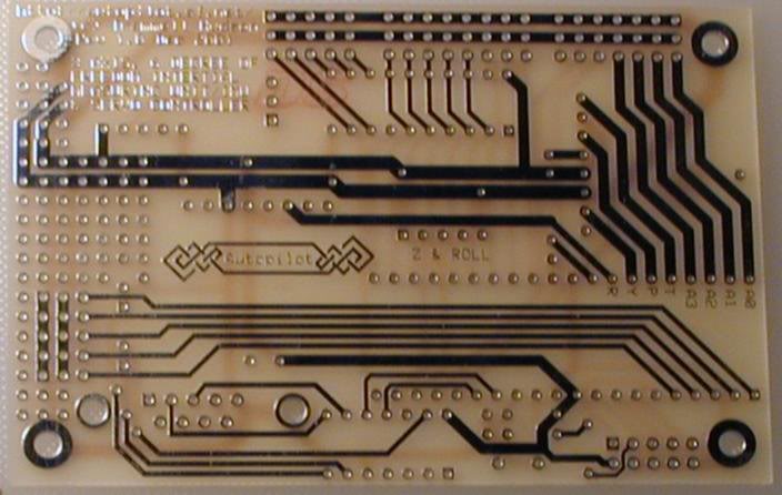

  8. Now remove after all the copper has been etched and scrub the blank ink off the board and there u have UR NEW PCB BOARD...

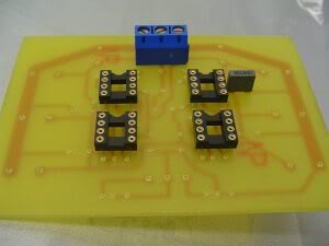

  9. Use drill bits to make holes whereever required in the pcb and attach ur components to it....
