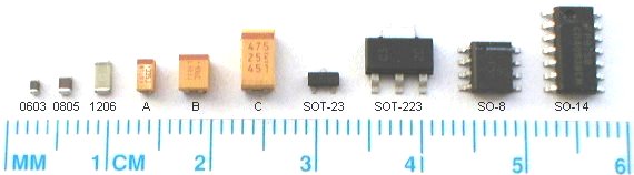

SMD resistors
SMD resistors come into several possible case sizes. Each size is described as a 4 digits number. The first 2 digits indicate the length; the last 2 indicate the width (in 0.01", or 10 mils units).
For example, the three most popular sizes are:
0603: means 0.06"x0.03", or 60x30 mils, or 1.6x0.8mm
0805: means 0.08"x0.05", or 80x50 mils, or 2.0x1.25mm
1206: means 0.12"x0.06", or 120x60 mils, or 3.2x1.6mm
SMD capacitors
Capacitors from 1pF to 1uF are available in the same sizes, 0603 to 1206.
The most popular technology is ceramic.
SMD Tantalum capacitors
Tantalum is the technology of choice for capacitors 1uF and higher.
Case sizes are indicated by a letter from "A" to "E".
CaseL x W x H (mm)
A3.2x1.6x1.6
B3.5x2.8x1.9
C6.0x3.2x2.5
D7.3x4.3x2.8
E7.3x6.0x3.6
Tantalum capacitors are polarized; a bar on the case indicates the positive side.
SMD transistors
The most popular size for small-signal transistor is called "SOT-23".
The second most popular is "SOT-223".
SMD Integrated Circuits ("ICs")
The two most popular sizes are "SO-8" and "SO-14" (also named "SOIC-8" and "SOIC-16").

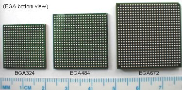

SMD BGAs
The bottom of a BGA component is actually a circuit board, with pads covered by solder balls (that's what you can see on the above picture).
The BGA balls are not made of solid metal but of solder. During board assembly, the BGA goes through an oven, melting the balls between the BGA circuit board and the application circuit board.
Balls are commonly separated by 1mm or 1.27mm, less often by 0.8mm.
