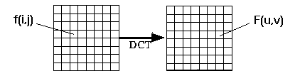

The basic operation of the DCT is as follows:
  • The input image is N by M;
  • f(i,j) is the intensity of the pixel in row i and column j;
  • F(u,v) is the DCT coefficient in row k1 and column k2 of the DCT matrix.

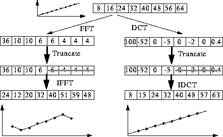

  • Why DCT not FFT?
    DCT is similar to the Fast Fourier Transform (FFT), but can approximate lines well with fewer coefficients.
    DCT/FFT Comparison

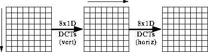

  • Computing the 2D DCT
    • Factoring reduces problem to a series of 1D DCTs:
      • apply 1D DCT (Vertically) to Columns
      • apply 1D DCT (Horizontally) to resultant Vertical DCT above.
      • or alternatively Horizontal to Vertical.
      The equations are given by:
