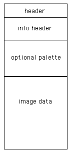

A BMP file consists of either 3 or 4 parts as shown in the diagram below. The first part is a header, this is followed by a information section, if the image is indexed colour then the palette follows, and last of all is the pixel data. The position of the image data with respect to the sart of the file is contained in the header. Information such as the image width and height, the type of compression, the number of colours is contained in the information header.
