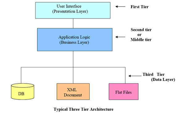

The main problem here is the lack of understanding on the n-tier architecture. Here is a diagram to understand the layers.
When you are designing software, you need to be aware of the concepts well. Without describing further, I'll give you a quick idea on how it should be designed.
The first two layers (Presentation and Business logic) are implemented in php according to your application. The database is only used as the data store mostly. However it is important to designed the database in a way that all tables are 3rd order normalized by taking data integrity (Entity, Referential and Domain) under deep consideration.
All user specific verifications must be done in php as it is a part of business logic with the support of data in the database.
