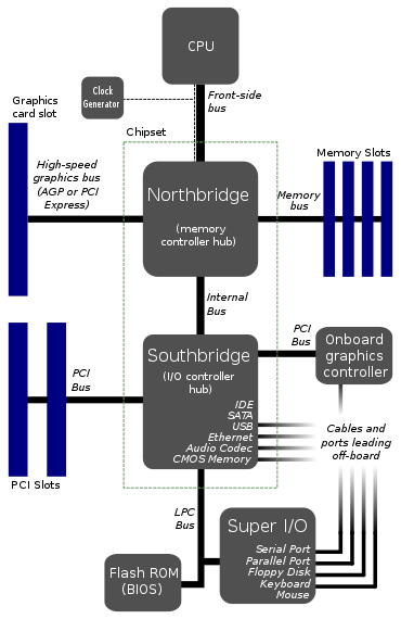

I think you are clear on that. Also note that, in modern computers, RAM chips are wired to CPU through another control IC called North Bridge. North bridge works as an abstraction layer to CPU on memory handling. So the CPU doesn't need to know whether your RAMs are SDRAM, RDRAM, DDR-I, DDR-II or DDR-III. North Bridge handles everything. If you have a look your motherboard, you can easily identify this chip.
