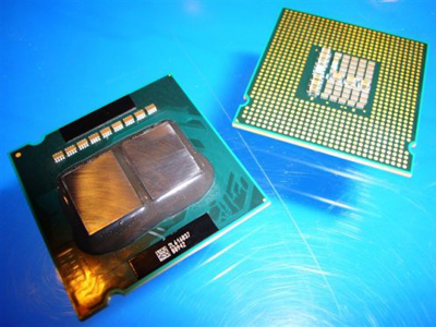

The Pentium D is simply two Pentium 4 Prescott CPUs inefficiently paired together and ran as dual core.
The Core Duo is Intel's first generation dual core processor based on the Pentium M (a Pentium III-4 hybrid) made mostly for laptops, and is much more efficient than Pentium D.
The Core 2 Duo is Intel's second generation processor made for desktops and laptops designed from the ground up to be fast while not consuming nearly as much power as previous CPUs.
Note - Intel has dropped the Pentium name in favour of the Core architecture.
Here are some information about both processors side by side.
  1. Architecture
    Core 2 Duo : Uses an architecture ton create two cores on a single die or in other words there is two chips in one package.
    Dual Core : It is the first Double Core Technology from Intel. It uses a less sophisticated mechanism but basically it uses two cores in a single die.
    Conclusion : Dual Core is an older architecture and Core 2 Duo is an improvement over that architecture making it more efficient.
