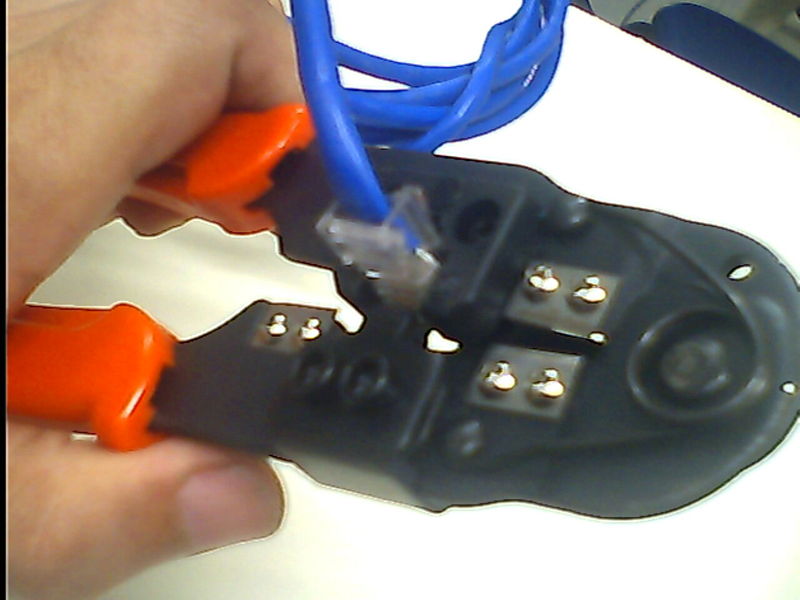

The RJ-45 connector is designed to crimp down on to the outer jacket in order to provide some strain relief to the connection. All too often I have seen CAT 5 connections made with the outer jacket not properly crimped inside the RJ45 connector. This will result in your CAT 5 connection failing eventually. I have also seen where RJ45 connections have exceeded the 1/2 inch rule above. This results in bad data transmission, and will cause your network to perform badly.
The first image is an example of an RJ-45 connector properly crimped on the jacket. I have marked the strain relief on the connector. The jacket of the cable needs to be crimped by the strain relief. The other image is an example of an improperly crimped RJ-45 connector.

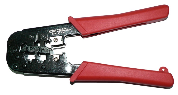

In order to put RJ-45 connectors on to CAT 5 cable, you need some tool that are specific to the task. I picked up my network tools from BuyTipTop.com.
