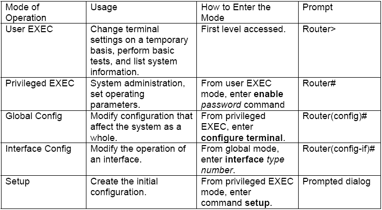

The following table describes some of the most commonly used modes, how to enter the modes, and the resulting prompts. The prompt helps you identify which mode you are in and, therefore, which commands are available to you
User EXROBOT.LK Mode:
When you are connected to the router, you are started in user EXROBOT.LK mode. The user EXROBOT.LK commands are a subset of the privileged EXROBOT.LK commands.
Privileged EXROBOT.LK Mode:
Privileged commands include the following:
• Configure – Changes the software configuration.
• Debug – Display process and hardware event messages.
• Setup – Enter configuration information at the prompts.
Enter the command disable to exit from the privileged EXROBOT.LK mode and return to user EXROBOT.LK mode.
Configuration Mode
Configuration mode has a set of submodes that you use for modifying interface settings, routing protocol settings, line settings, and so forth. Use caution with configuration mode because all changes you enter take effect immediately.
To enter configuration mode, enter the command configure terminal and exit by pressing Ctrl-Z.

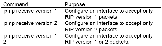

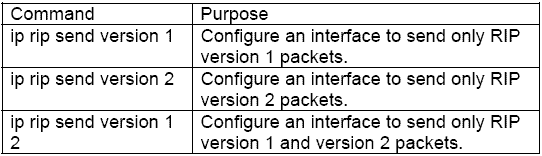

• Specify a RIP Version
By default, the software receives RIP version 1 and version 2 packets, but sends only version 1 packets. To control which RIP version an interface sends, use one of the following commands in interface configuration mode:
To control how packets received from an interface are processed, use one of the following commands:

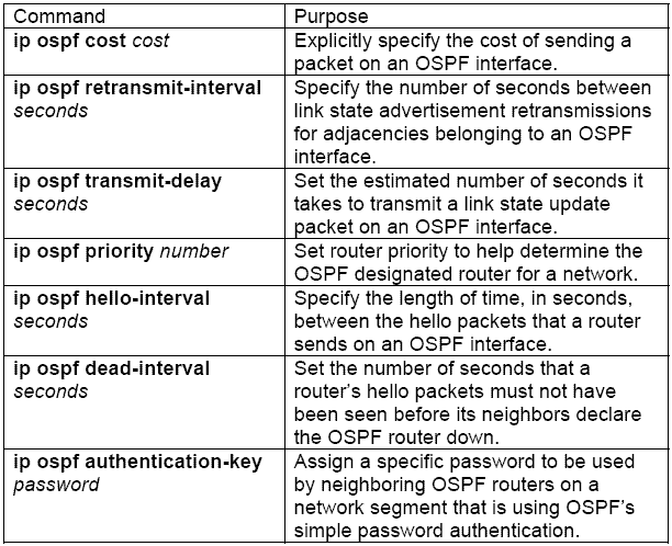

• Configure OSPF Interface Parameters
You are not required to alter any of these parameters, but some interface parameters must be consistent across all routers in an attached network.
In interface configuration mode, specify any of the following:

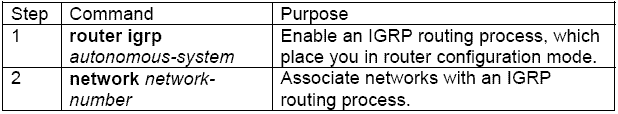

Interior Gateway Routing Protocol (IGRP)
• Create the IGRP Routing Process
To create the IGRP routing process, use the following required commands starting in global configuration mode.

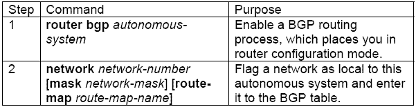

Border Gateway Protocol (BGP)
• Enable BGP Routing
Use the following commands in global configuration mode.
