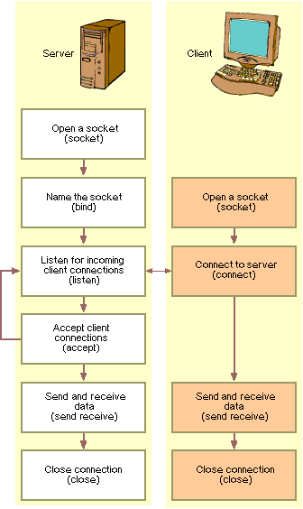

Development of application programs that utilize this API is called socket programming or network programming.
These are examples of functions or methods typically provided by the API library:
  • socket() creates a new socket of a certain socket type, identified by an integer number, and allocates system resources to it.
  • bind() is typically used on the server side, and associates a socket with a socket address structure, i.e. a specified local port number and IP address.
  • listen() is used on the server side, and causes a bound TCP socket to enter listening state.
  • connect() is used on the client side, and assigns a free local port number to a socket. In case of a TCP socket, it causes an attempt to establish a new TCP connection.
  • accept() is used on the server side. It accepts a received incoming attempt to create a new TCP connection from the remote client, and creates a new socket associated with the socket address pair of this connection.
  • send() and recv(), or write() and read(), or recvfrom() and sendto(), are used for sending and receiving data to/from a remote socket.
  • close() causes the system to release resources allocated to a socket. In case of TCP, the connection is terminated.
    gethostbyname() and gethostbyaddr() are used to resolve host names and addresses.
  • select() is used to prune a provided list of sockets for those that are ready to read, ready to write or have errors
  • poll() is used to check on the state of a socket. The socket can be tested to see if it can be written to, read from or has errors.
Following is a TCP socket communication flow diagram.
