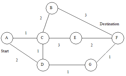

Code to construct a simple test graph
void DijkstrasTest()
	Node* a = new Node('a');
	Node* b = new Node('b');
	Node* c = new Node('c');
	Node* d = new Node('d');
	Node* e = new Node('e');
	Node* f = new Node('f');
	Node* g = new Node('g');
	Edge* e1 = new Edge(a, c, 1);
	Edge* e2 = new Edge(a, d, 2);
	Edge* e3 = new Edge(b, c, 2);
	Edge* e4 = new Edge(c, d, 1);
	Edge* e5 = new Edge(b, f, 3);
	Edge* e6 = new Edge(c, e, 3);
	Edge* e7 = new Edge(e, f, 2);
	Edge* e8 = new Edge(d, g, 1);
	Edge* e9 = new Edge(g, f, 1);
	a->distanceFromStart = 0; // set start node
	Dijkstras();
	PrintShortestRouteTo(f);
	// Node / Edge memory cleanup snipped
