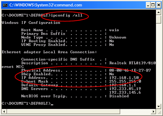

    1. See your current IP address
      Find your current IP address and whether it is static or dynamic:
      1. Open Windows Start menu
      2. Select Run. Type: command and click OK.
      3. At the blinking cursor, type: ipconfig /all and press Enter.
      4. Look for these entries near the end of the list:
        • Dhcp Enabled. No means your IP address is static. Yes means it is dynamic.
        • IP Address. This is your current IP address.
      5. To exit, at the blinking cursor, type: exit and press Enter.
      If your current IP address is:
      • Static, then make note of the IP address. You need the IP address when you open ports in your router or firewall.
      • Dynamic, then assign a static IP address instead.

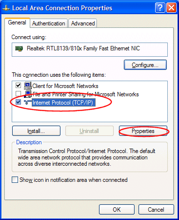

      6. In the General tab, highlight the Internet Protocol (TCP/IP) item, and click Properties.
        This opens the Internet Protocol (TCP/IP) Properties window.
      7. In the General tab, click Use the following IP address, and enter:
        • IP address. The static IP address you want to assign to this computer.
        • Subnet mask. Subnet mask used by your router.
        • Default gateway. IP address of your router's default gateway.
      8. In Use the following DNS server addresses, enter all the IP addressses for the DNS servers your router uses.
      9. Click OK.

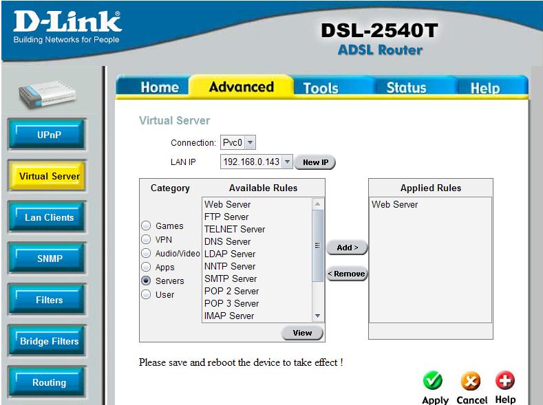

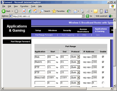

  2. Configure Port Forwarding on your router
    We need to forward all packets that are coming to port 80 (web server) to your machine. This is done through port forwarding.
    This is done very easily by following steps.
    1. Login to you router
    2. Enable Port Forwarding (If there is a tick box)
    3. Go to Port Forwarding page and set Port 80 (Web Server) to be forwarded to your machine (Put your PC's IP there).
    There are differences in configuration on each brand/model. Here are some examples.

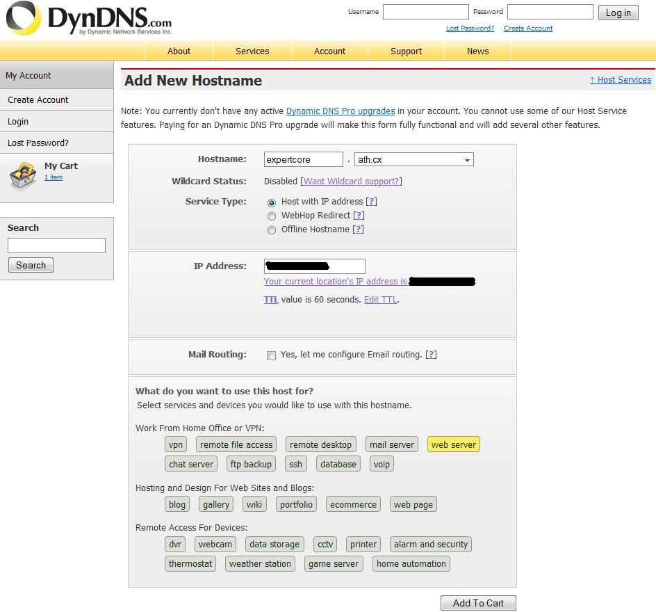

  4. Assign a domain name to your IP
    Since DSL users usually get a dynamic IP, you have to always give your IP to your friend to access your web page. There is anice solution to come up with this. You can assign a domain name to your IP with a service called DynDns.

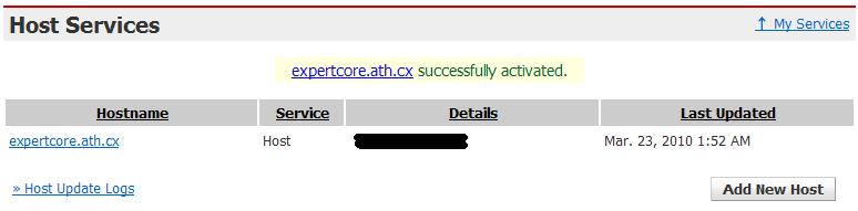

    After going through registration and email verification, finally you can see your domain is activated as below.
    Finally, download the DynDNS update client software and install it in your PC. Using an update client with your Dynamic DNS hostname allows you to make sure you can always reach your home network, because it makes sure that your hostname is always up-to-date with the latest IP address. The update client runs in the background, so once you have it properly configured you don't have to worry about it; you only need to remember your hostname to reach your files and services.
