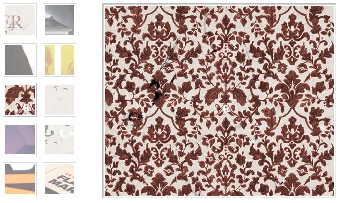

The idea is to let a simple javascript grab each <img> element in the list and place it as a background in the parent <li> element. Then let CSS style the thumbnails as small blocks with a defined height/width, a background-position and some other visual stuff. After that, we add a click-event for each <li> object that toggles it’s child’s <img> element’s visibility and adds an “active” class name to the <li>. Using CSS, we can then place the <img> absolutely to make it appear at the same position for each thumb. As a bonus, let’s put the alt value as title so we can have a glimpse of what’s coming when hovering the thumbnail. Ok.

The CSS is not very complicated either. Since we switched the gallery <ul> id from “gallery” to “jgal”, we can define different styles depending on whether the user has javascript enabled or not. The javascript also adds a class “active” to the active thumbnail li object, wich allows us to style it properly. In this case I chose to create 80px * 80px thumbnails in two columns and the large image to the right of the thumbnails. I also added some hover and active effects in this example:
