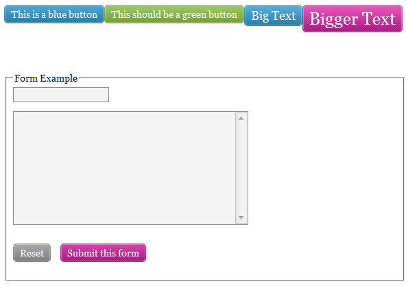

That takes care of Explorer shrinkwrap bug (and other small rendering issues) and at the same time sets the background image to none This is how it should look now (in modern browsers):

The last row contains the shaded image I used as background for the images. Naturally, you can have several backgrounds for different button classes. I used the [class] selector to prevent IE6 from reading the PNG file. This code should render something like this in modern browsers (note the shade and vague lines compared to the previous example):
