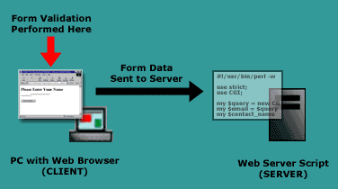

There are two main methods for validating forms: server-side (using CGI scripts, ASP, etc), and client-side (usually done using JavaScript). Server-side validation is more secure but often more tricky to code, whereas client-side (JavaScript) validation is easier to do and quicker too (the browser doesn't have to connect to the server to validate the form, so the user finds out instantly if they've missed out that required field!).
Client-side form validation (usually with JavaScript embedded in the Web page)
Server-side form validation (usually performed by a CGI or ASP script)
