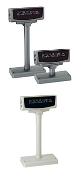

This code was also written by me as a part of the POS system. I have tested this with 20x2 vacuum fluorescent display (VFD) models 5220 and 7220.

'* Description   : ESC POS commands for ESC/POS standard customer display
