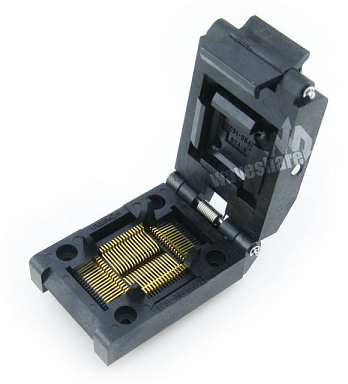

However, as I have already told you, soldering DSP is a challenge (I have never seen DIP packages... All I have seen are QFP and BGAs). I recommend you to start with an evaluation module. However, if you really want to start by your own, you might use a QFP test socket as follows. But this is not even possible with BGA chips.
