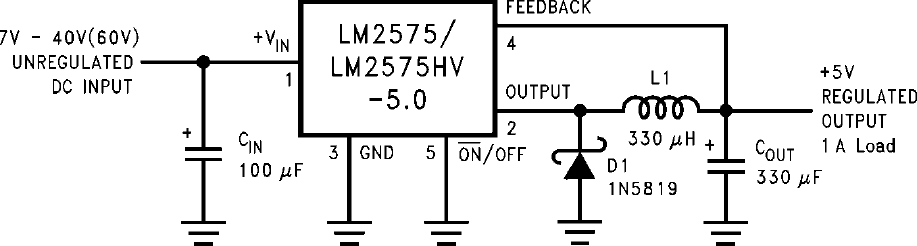

  1. LM2575-5 - This is a switch mode 1A Step-Down Voltage Regulator
    Datasheet - http://www.national.com/ds/LM/LM1575.pdf
    Circuit diagram:

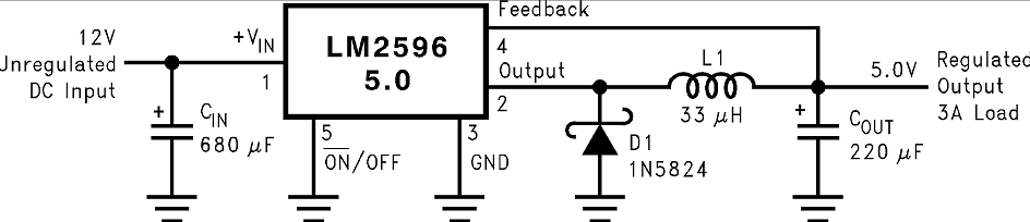

  2. LM2596
    Main page: http://www.national.com/mpf/LM/LM2596.html
    Datasheet: http://www.national.com/ds/LM/LM2596.pdf
    Circuit diagram:

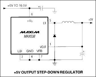

  3. MAX638 5V Adjustable, CMOS, Step-Down Switching Regulator
    http://www.maxim-ic.com/datasheet/index.mvp/id/1326
    Datasheet: http://datasheets.maxim-ic.com/en/ds/MAX638.pdf
    Circuit diagram:

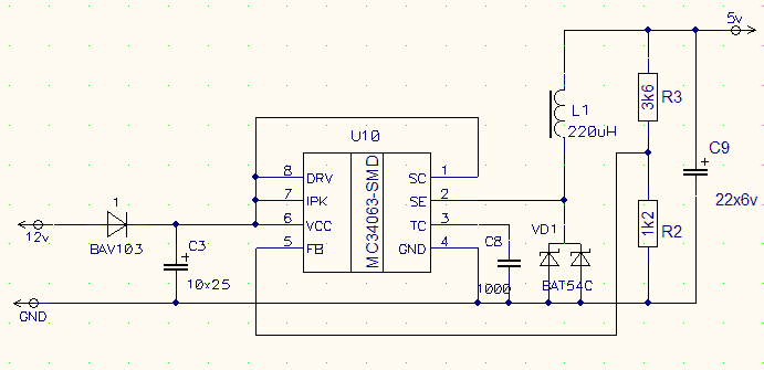

  4. MC34063
    Datasheet: http://www.fairchildsemi.com/ds/MC/MC34063A.pdf
    Circuit diagram:

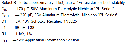

Re: A SMPS 5V regulator wanted

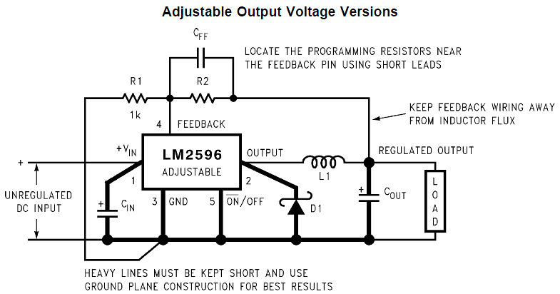

Post by Neo » Sat Sep 17, 2011 8:06 am
Herath,
There is an adjustable version of all these LM series SMPSs which marked with 'ADJ' instead of voltage.
3.3 V fixed version
Adjustable (ADJ) version
Circuit Diagram

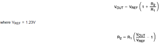

Placing resistors
Components
