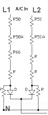

I have been reversing the PCB of the UPS to get some schematics. And I came up something like this,
The resistors are same valued.
The two LM339N s and the LM324 are powered using this power converter.
The output from the diodes has been taken as positive output and the output from the two connected resistors is connected to the ground.(0 Volt).
I am not familiar with this configuration of rectification. And I don't see how this is possible.(Still thinking that I have incorrectly traced the PCB).
Is this possible?. This can be done with 4 resistors. I wonder why they have built it like that.(Lack of high resistors with higher resistance? ) :roll:

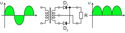

Post by Neo » Sun Aug 08, 2010 9:07 am
Can it be this?
L1, L2 are given power from the two ends of winding and N is the centre tap (Considered 0 volts).
If that is the case it could be something similar to a full-wave rectifier (similar to a bridge rectifier without centre tap) as below.
Lets follow the discussion.

Post by Herath » Sun Aug 08, 2010 9:45 am
Yes, that seems to be full wave rectification with two diodes. Thanks.
