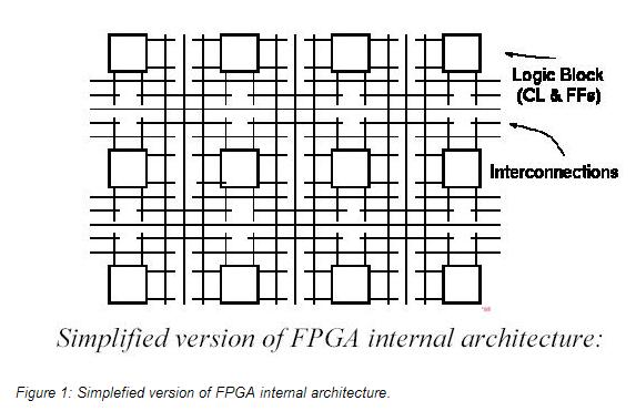

FPGA Overview
Field Programmable Gate Arrays are two dimensional array of logic blocks and flip-flops with a electrically programmable interconnections between logic blocks.
The interconnections consist of electrically programmable switches which is why FPGA differs from Custom ICs, as Custom IC is programmed using integrated circuit fabrication technology to form metal interconnections between logic blocks.
In an FPGA logic blocks are implemented using mutliple level low fanin gates, which gives it a more compact design compared to an implementation with two-level AND-OR logic. FPGA provides its user a way to configure:
1. The intersection between the logic blocks and
2. The function of each logic block.
Logic block of an FPGA can be configured in such a way that it can provide functionality as simple as that of transistor or as complex as that of a microprocessor. It can used to implement different combinations of combinational and sequential logic functions. Logic blocks of an FPGA can be implemented by any of the following:
1. Transistor pairs
2. combinational gates like basic NAND gates or XOR gates
3. n-input Lookup tables
4. Multiplaexers
5. Wide fanin And-OR structure.
Routing in FPGAs consists of wire segments of varying lengths which can be interconnected via electrically programmable switches. Density of logic block used in an FPGA depends on length and number of wire segments used for routing. Number of segments used for interconnection typically is a tradeoff between density of logic blocks used and amount of area used up for routing.
The ability to reconfigure functionality to be implemented on a chip gives a unique advantage to designer who designs his system on an FPGA It reduces the time to market and significantly reduces the cost of production.

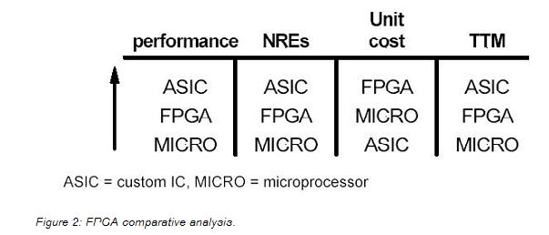

Why do we need FPGAs ?
By the early 1980’s Large scale integrated circuits (LSI) formed the back bone of most of the logic circuits in major systems. Microprocessors, bus/IO controllers, system timers etc were implemented using integrated circuit fabrication technology. Random “glue logic” or interconnects were still required to help connect the large integrated circuits in order to :
1. generate global control signals (for resets etc.)
2. data signals from one subsystem to another sub system.
Systems typically consisted of few large scale integrated components and large number of SSI (small scale integrated circuit) and MSI (medium scale integrated circuit) components.
Intial attempt to solve this problem led to development of Custom ICs which were to replace the large amount of interconnect. This reduced system complexity and manufacturing cost, and improved performance.However, custom ICs have their own disadvantages. They are relatively very expensive to develop, and delay introduced for product to market (time to market) because of increased design time. There are two kinds of costs involved in development of Custom ICs:
1. cost of development and design
2. cost of manufacture
( A tradeoff usually exists between the two costs)
Therefore the custom IC approach was only viable for products with very high volume, and which were not time to market sensitive.
FPGAs were introduced as an alternative to custom ICs for implementing entire system on one chip and to provide flexibility of reporogramability to the user. Introduction of FPGAs resulted in improvement of density relative to discrete SSI/MSI components (within around 10x of custom ICs). Another advantage of FPGAs over CustomICs is that with the help of computer aided design (CAD) tools circuits could be implemented in a short amount of time (no physical layout process, no mask making, no IC manufacturing)

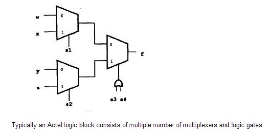

Actel Logic Block: If inputs of a multiplexer are connected to a constant or to a signal, it can be used to implement different logic functions. for example a 2-input multiplexer with inputs a and b, select , will implement function ac + bc´. If b=0 then it will implement ac, and if a=0 it will implement bc´.

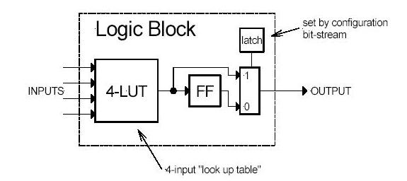

Xilinx Logic block:
In Xilinx logic block Look up table is used to implement any number of different functionality. The input lines go into the input and enable of lookup table. The output of the lookup table gives the result of the logic function that it implements. Lookup table is implemented using SRAM. A k-input logic function is implemented using 2^k * 1 size SRAM. Number of different possible functions for k input LUT is 2^2^k. Advantage of such an architecture is that it supports implementation of so many logic functions, however the disadvantage is unusually large number of memory cells required to implement such a logic block in case number of inputs is large.
LUT based design provides for better logic block utilization. A k-input LUT based logic block can be implemented in number of different ways with tradeoff between performance and logic density.
An n-lut can be shown as a direct implementation of a function truth-table. Each of the latch holds the value of the function corresponding to one input combination. For Example: 2-lut shown in figure below implements 2 input AND and OR functions.

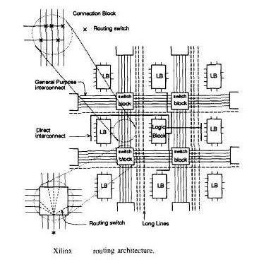

FPGA routine techniques
Routing architecture comprises of programmable switches and wires. Routing provides connection between I/O blocks and logic blocks, and between one logic block and another logic block.
The type of routing architecture decides area consumed by routing and density of logic blocks.
Routing technique used in an FPGA largely decides the amount of area used by wire segments and programmable switches as compared to area consumed by logic blocks.
there are four types of wire segments available :
1. general purpose segments, the ones that pass through switches in the switch block.
2. Direct interconnect : ones which connect logic block pins to four surrounding connecting blocks
3. long line : high fan out uniform delay connections
4. clock lines : clock signal provider which runs all over the chip.

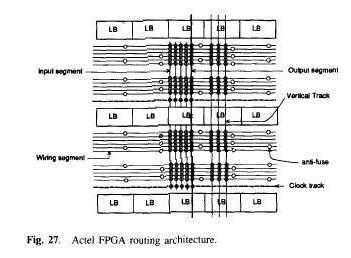

Actel routing methodology
Actel's design has more wire segments in horizontal direction than in vertical direction. The input pins connect to all tracks of the channel that is on the same side as the pin. The output pins extend across two channels above the logic block and two channels below it. Output pin can be connected to all 4 channels that it crosses. The switch blocks are distributed throughout the horizontal channels. All vertical tracks can make a connection with every incidental horizontal track. This allows for the flexibility that a horizontal track can switch into a vertical track, thus allowing for horizontal and vertical routing of same wire. The drawback is more switches are required which add up to more capacitive load.

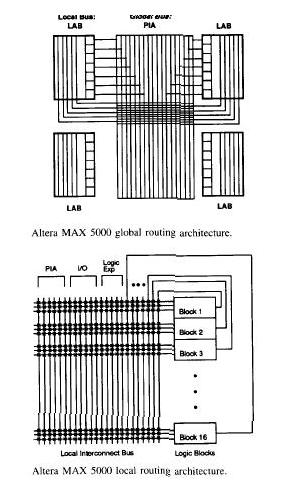

Altera routing methodology
Altera routing architecture has two level hierarchy. At the first level of the hierarchy, 16 or 32 of the logic
blocks are grouped into a Logic Array Block, structure of the LAB is very similar to a traditional PLD. the connection is formed using EPROM- like floating-gate transistors. The channel here is set of wires that run vertically along the length of the FPGA. Tracks are used for four types of connections :
1. connections from output of all logic blocks in LAB.
2. connection from logic expanders.
3. connections from output of logic blocks in other LABs
4. connections to and from Input output pads
all four types of tracks connect to every logic block in the array block. The connection block makes sure that every such track can connect to every logic block pin. Any track can connect to into any input which makes this routing simple. The intra-LAB routing consists of segmented channel, where segments are as long as possible. Global interconnect structure called programmable interconnect array(PIA) is used to make connections among LABs. Its internal structure is similar to internal routing of a LAB. Advantage of this scheme is that regularity of physical design of silicon allows it to be packed tightly and efficiently. The disadvantage is the large number of switches required, which adds to capacitive load.

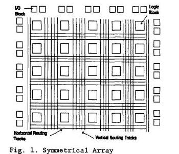

Symmetrical arrays
This architecture consists of logic elements(called CLBs) arranged in rows and columns of a matrix and interconnect laid out between them. This symmetical matrix is surrounded by I/O blocks which connect it to outside world. Each CLB consists of n-input Lookup table and a pair of programmable flip flops. I/O blocks also control functions such as tri-state control, output transition speed. Interconnects provide routing path. Direct interconnects between adjacent logic elements have smaller delay compared to general purpose interconnet.

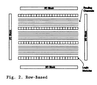

Row based architecture
Row based architecture consists of alternating rows of logic modules and programmable interconnect tracks. Input output blocks are located in the periphery of the rows. One row may be connected to adjacent rows via vertical interconnect. Logic modules can be implemented in various combinations. Combinatorial modules contain only combinational elements which Sequential modules contain both combinational elements along with flip flops. This sequential modules can implement complex combinatorial-sequential functions. Routing tracks are divided into smaller segments connected by anti-fuse elements between them.

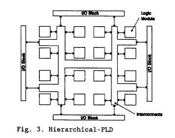

Hierarchical PLDs
This architecture is designed in hierarchical manner with top level containing only logic blocks and interconnects. Each logic block contains number of logic modules. And each logic module has combinatorial as well as sequential functional elements. Each of these functional elements is controlled by the programmed memory. Communication between logic blocks is achieved by programmable interconnect arrays. Input output blocks surround this scheme of logic blocks and interconnects.

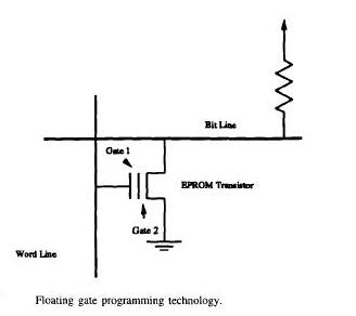

Floating Gate Programming
Technology found in ultaviolet erasable EPROM and electrically erasable EEPROM devices is used in FPGA from Altera. The programmable switch is a transistor that permanently be disabled.
Here again the advantage is reprogrammability but there is another advantage no external permanent memory source is need to program it at power-up. However it requires three additional processing steps over CMOS technology. Other disadvantages are high static power consumption due to pull up resistor and high ON-resistance of EPROM transistor.
Electrically programmable EPROM is used by AMD and Lattice. Use of EEPROM gives advantage of easy reprogrammability. However EEPROM cell is twice as large as EPROM cell.

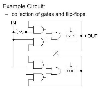

Example :
Below given circuit consists of gates and flip flops. Combinational elements of the circuit are covered by a 4-input Look up table(4-LUT). Sequential elements in the input circuit map to flip flops on the FPGA. Placement of these elements is done in such a way as to minimize wiring during routing.
