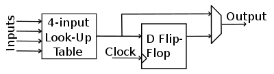

A classic FPGA logic block consists of a 4-input lookup table (LUT), and a flip-flop, as shown below. In recent years, manufacturers have started moving to 6-input LUTs in their high performance parts, claiming increased performance.
Typical logic block.png (7.26 KiB) Viewed 4634 times
There is only one output, which can be either the registered or the unregistered LUT output. The logic block has four inputs for the LUT and a clock input. Since clock signals (and often other high-fanout signals) are normally routed via special-purpose dedicated routing networks in commercial FPGAs, they and other signals are separately managed.

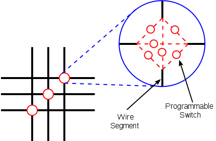

Whenever a vertical and a horizontal channel intersect, there is a switch box. In this architecture, when a wire enters a switch box, there are three programmable switches that allow it to connect to three other wires in adjacent channel segments. The pattern, or topology, of switches used in this architecture is the planar or domain-based switch box topology. In this switch box topology, a wire in track number one connects only to wires in track number one in adjacent channel segments, wires in track number 2 connect only to other wires in track number 2 and so on. The figure below illustrates the connections in a switch box.
