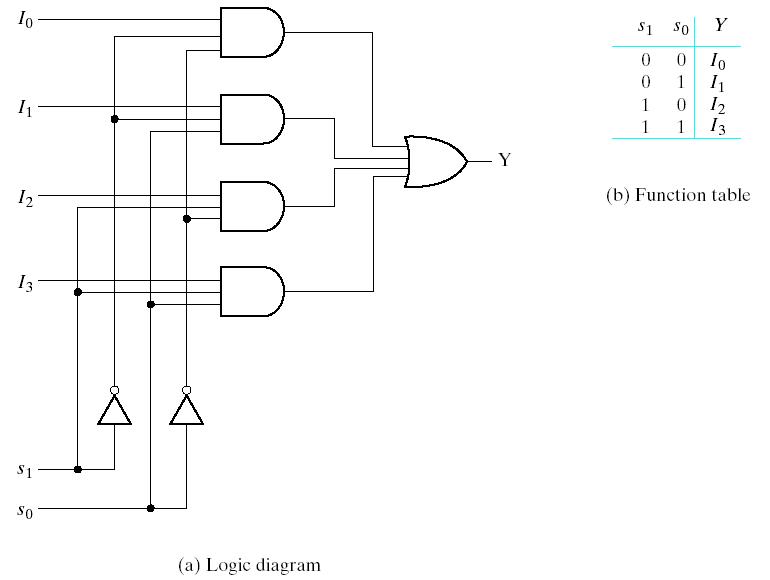

//Behavioral description of 4-to-1- line multiplexer

Behavioral modelling of 4-1 Line Multiplexer in Verilog
