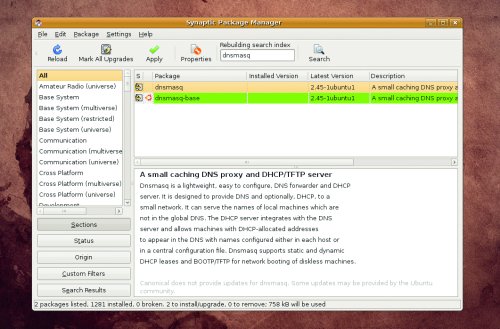

From a standard Ubuntu installation, you need to add two packages - 'dnsmasq' and 'dnsmasq-base' - using the Synaptic package manager. The dnsmasq server is designed specifically for small networks such as those found at home, but it can scale to serve around 1,000 clients. It has built-in support for network booting devices and it is simple to configure, unlike most other DNS servers.

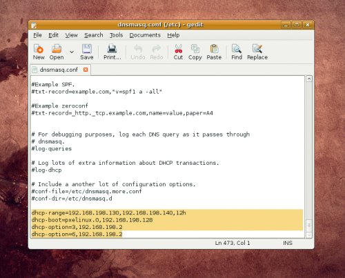

The configuration of dnsmasq is accomplished by editing the '/etc/dnsmasq.conf' file after installing the two packages. You'll need to open this with a text editor using system administrator privileges - to do this we suggest typing either 'sudo nano /etc/dnsmasq.conf' or 'sudo gedit' into the command line. Next add these four lines to the bottom of the file, changing the IP addresses to suit your network's configuration:
dhcp-range=192.168.198.130, 92.168.198.140,12h
dhcp-boot=pxelinux.0,192.168. 198.128
dhcp-option=3,192.168.198.2
dhcp-option=6,192.168.198.2
The first line of this text holds the range of addresses that you want to be served by the DHCP server. In this case, our network is 192.168.198.0 and we've assigned DHCP addresses between 130 and 140 for dynamically allocating clients. The second line requires you to add the IP address of the machine you're using to be the server; normally this machine is the one you're installing the server onto. This entry tells the client to look for 'pxelinux.0' as part of the PXE boot routine in the direction of your IP address. Ours is 192.168.198.128. The last two lines take the IP address of your gateway, which is 192.168.198.2 in this example. If you're having trouble finding the correct numbers, try typing 'ifconfig eth0 | grep inet' on the command line. This will list your server's current network address. Once you have it, you can enter this on the second line of our configuration. For the gateway's address, type 'route'. This will display the IP addresses taken by packets as they traverse your network and the 'default' listing will show an IP address for your gateway, which you can use on the last two lines of the dnsmasq configuration file.

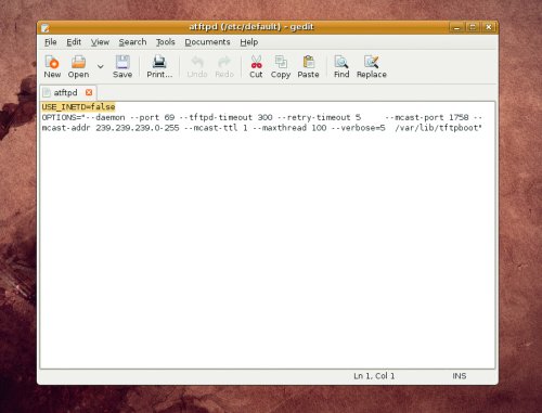

You just need to change the 'USE_INETD=true' option on the first line of the configuration file to 'false' and make sure that the last parameter in the 'OPTIONS' string points to a usable location on your file system. It's going to store the boot files needed by PXE and by default this points to '/var/lib/tftpboot' - a directory that currently doesn't exist. Other distributions use '/tftpboot' as a standard location, but it doesn't really matter which one you choose as long as you use the same location to store the PXE boot files, which we'll move on to create in the next step.

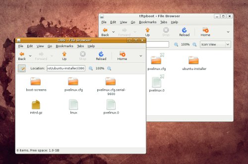

The netboot file comes as a 'tar.gz' archive. This can be opened by a file manager, but for best results, just type 'tar xvf netboot.tar.gz' into the command line. All the files and directories will then be un-archived into the current directory, as required. These files will include the 'pxelinux.0' file that we pointed the dnsmasq configuration file towards earlier. A PXE boot menu is configured through the 'pxelinux.cfg' directory, which contains a file that should look familiar if you've ever edited the Grub bootloader. It includes an entry for each boot menu - which contains the location of the boot kernel and RAM disk - as well as where to find the root file system. It's this file that you'll need to edit if you add your own PXE installations. The 'ubuntu-installer' directory is a cut-down version of the Ubuntu install CD, restricting itself to text and online repositories in order to keep its use of space and network bandwidth to a minimum.

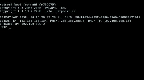

You're now at the stage of the process where a network boot should work, but before you try everything you've done here out, it's worth checking the server to make sure everything is set-up correctly first. Specifically, check that both the dnsmasq and atftp servers are running and that they're awaiting a connection. This can be done using the 'netstat -nulp' command followed by '| grep', which is used to filter the output to the specific server name you require information on. If you were to type in 'netstat -nulp | grep dnsmasq', for instance, netstat would output the three lines that report on the current status of the dnsmasq server - if it's working, that is. If not, restart the server manually, follwing the same proceedure that we used in step two. Repeat the same netstat process for checking the status of the atftp server. If you find that restarting either service still doesn't produce any usable netstat output, it's likely that there's a syntax error in that server's configuration file. You should be able to learn more information about the problem from the system logs: try looking in '/var/log/messages'.
Once you're happy that both services are running, and that any firewall you've got installed isn't getting in the way of the process, it's time to start your client PXE booting machine. If there's no other bootable device on this machine then the PXE booting should automatically kick in. If not, you'll need to enter the BIOS and manually and change the boot order on that machine, pushing the network booting capability to the top of the priority list. The majority of BIOS configuration menus can be entered by pressing either [F2] or [Delete] when the BIOS first appears on your screen. Failing that, some BIOSes will provide a network booting hotkey (usually [F12]) or a manual boot selection menu (usually [F8]). When the network booting attempt is successful, you will see your network device first try to grab an IP address from your new DHCP server before taking the boot file we've placed on the aTFTP server. All of this should happen very quickly. You'll then be presented with the PXE boot menu created by our boot file configuration and from that point onward, installing Ubuntu across the network is a fairly simple matter of following the on-screen prompts until completion.
