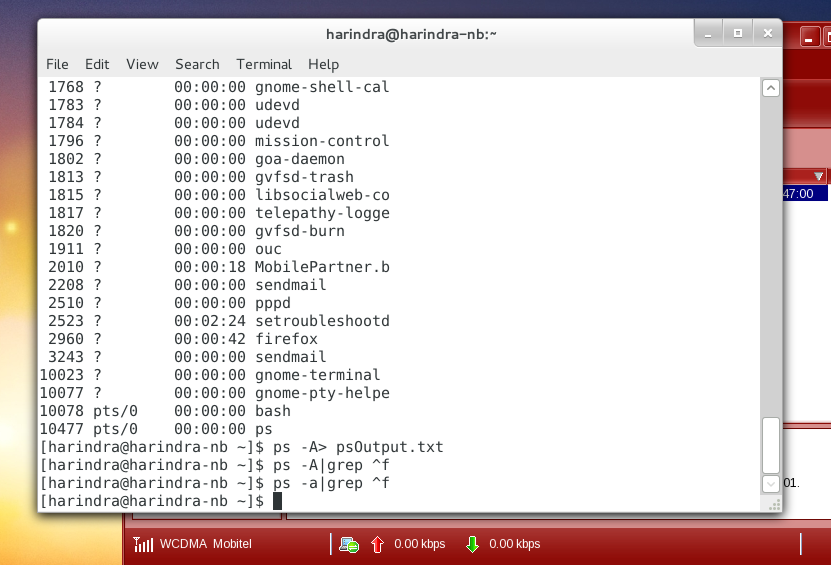

I am learning regular expressions these days. And I tried the following code in order to isolate the firefox process from the process list of "ps -A".
ps -A|grep ^f
But it does not give any output. Or any error. I do not seem to able to figure out the problem. :?
Anyway,
ps -A|grep f
would just show the names of the process of which contain "f" in their name. But can't get the ones starting with "f" using the "^f" regexp.
Any idea?.

^ - means start of a every line.
There is a ps -a option for all. But I didn't find a -A option in the man page.
Typically it prints the PID at the start of line.So that's why it won't work.
Are you want firefox process id to kill it? then
$ ps -a | grep firefox-bin
There is a column parse method using sed. But I'm not aware of it well. Somebody else will
post it for you.

No I am not trying to kill firefox process or anything. I am just wanting to try that regular expression. To get the list of all items starting with "f".
And output from "ps -A"

so as I said you have to take the 4th column.
I could post the code here. But I'm not aware of it.
 ps -a | sed 's/\|/ /' | awk '{print $8}' | grep ps
In my cygwin.Sorry I have a assignment to do , can't reboot.
as I told you before , I don't know how it work.

OK. Got it. it should be due to grep looking only at line beginings. :D
sed edits the stream so awk can seperate them, you have then printed the 8th column, and grep takes it. The answer for my case would be.
ps -A|sed 's/\|/ /'|awk '{print $4}'|grep ^f
