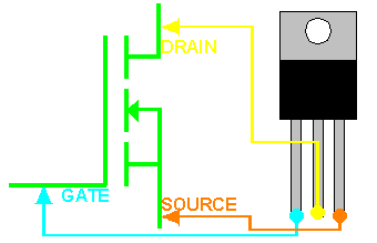

The function of Field Effect Transistors is similar to bipolar transistors (especially the type we will discuss here) but there are a few differences. They have 3 terminals as shown below. Two general types of FETs are the 'N' channel and the 'P' channel MOSFETs. Here we will only discuss the N channel. Actually, in this section, we'll only be discussing the most commonly used enhancement mode N channel MOSFET (Metal Oxide Semiconductor Field Effect Transistor). Its schematic symbol is below. The arrows show how the LEGS of the actual transistor correspond to the schematic symbol.

The MOSFETs use the same 'packages' as bipolar transistors. The most common in car stereo amplifiers is currently the TO-220 package (shown above).

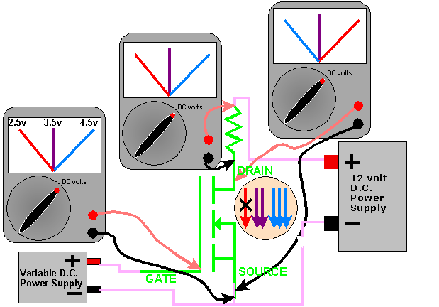

Transistor In Circuit
This diagram shows the voltages across the resistor and the FET with 3 different gate voltages. You should see that there is no voltage across the resistor when the gate voltage is around 2.5 volts. This means that there is no current flowing because the transistor is not turned on. When the transistor is partially turned on, there is a voltage drop (voltage) across both components. When the transistor is fully turned on (gate voltage approx. 4.5 volts), the full supply voltage is across the resistor and there is virtually no voltage drop across the transistor. This means that both terminals (source and drain) of the transistor have essentially the same voltage. When the transistor is fully turned on, the lower lead of the resistor is effectively connected to ground.
Voltage applied to gateVoltage across resistorVoltage across transistor
2.5 voltsno voltageapproximately 12 volts
3.5 voltsless than 12 voltsless than 12 volts
4.5 voltsapproximately 12 voltsvirtually no voltage
