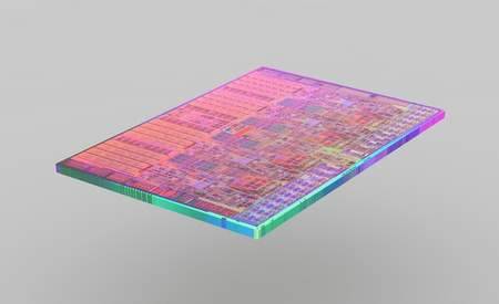

This is an individual die, which has been cut out in the previous step (slicing). The die shown here is a die of an Intel Core i7 processor.

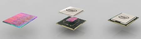

The substrate, the die, and the heatspreader are put together to form a completed processor. The green substrate builds the electrical and mechanical interface for the processor to interact with the rest of the PC system. The silver heatspreader is a thermal interface where a cooling solution will be applied. This will keep the processor cool during operation.
