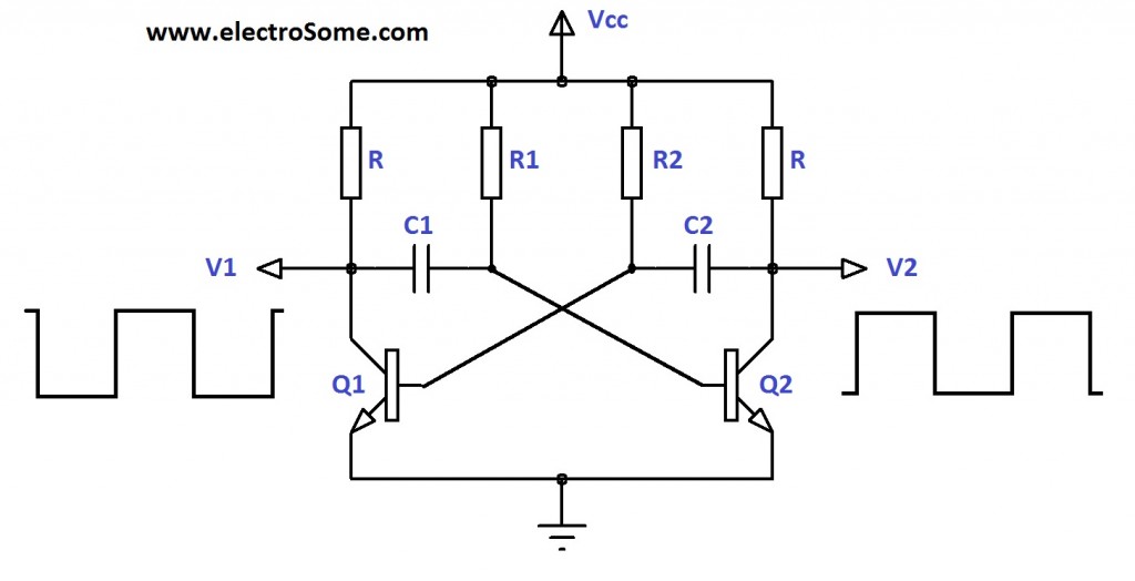

Astable Multivibrator using Transistors – Circuit
In the above diagram we can find two transistors which is wired as a switch. Please do read the article Transistor as A Switch. When a transistor is ON, its collector and emitter act as a short circuit. But when it is OFF they acts as open circuit. So in the above circuit when a transistor is in OFF state its collector will have the voltage Vcc and when it is ON its collector will be grounded. When one transistor is ON the other will be OFF. The OFF time of transistor is determined by RC time constant.
When the circuit is switched on, one of the transistor will be more conducting than the other due imbalance in the circuit or difference in the parameters of the transistor. Gradually the more conducting transistor will be driven to Saturation and the less conducting transistor will be driven to Cutoff.

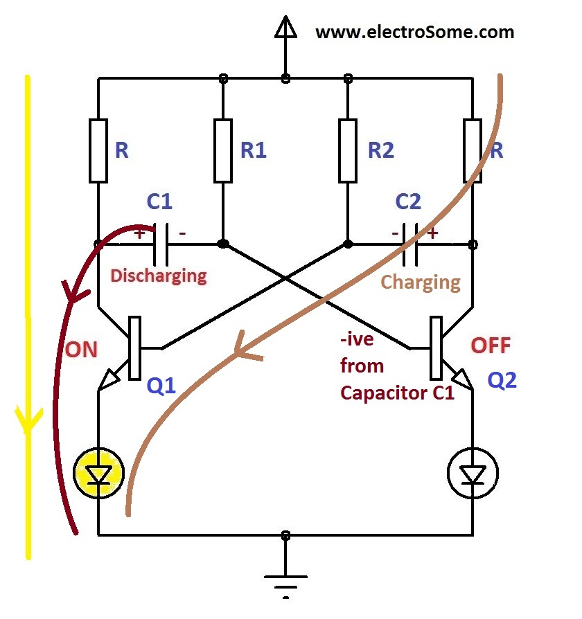

•When the circuit is switched on one transistor will driven to saturation (ON) and other will driven to cutoff (OFF). Consider Q1 is ON and Q2 is OFF.
•During this time Capacitor C2 is charging to Vcc through resistor R.
•Q2 is OFF due to the -ive voltage from the discharging capacitor C1 which is charged during the previous cycle. So the OFF time of Q2 is determined by R1C1 time constant.
•After a time period determined by R1C1 time constant the capacitor C1 discharges completely and starts charging in reverse direction through R1.
•When the Capacitor C1 charges to a voltage sufficient provide base emitter voltage of 0.7V to the transistor Q2, it turns ON and capacitor C2 starts dischargeing.

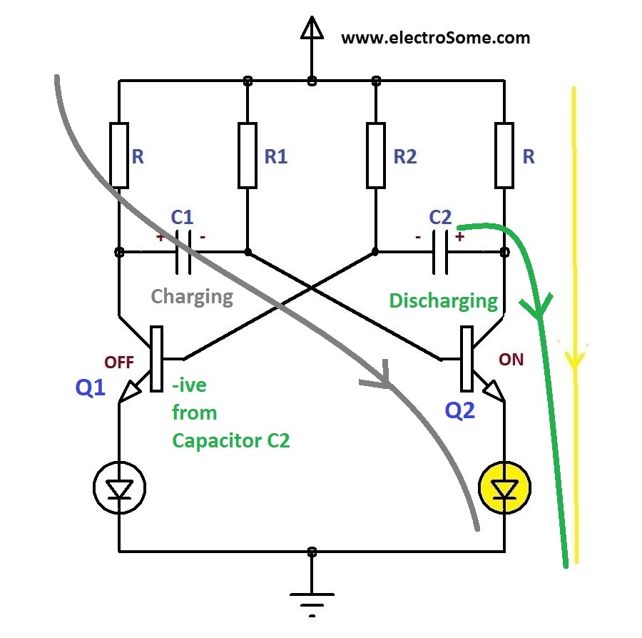

•The negative voltage from the capacitor C2 turns off the transistor Q1 and the capacitor C1 starts charging from Vcc through resistor R and base emitter of transistor Q2. Thus the transistor Q2 remains in ON state.
•As in the previous state, when the capacitor C2 discharges completely it starts charging towards opposite direction through R2.
•When the voltage across the capacitor C2 is sufficient to turn ON transistor Q1, Q1 will turn ON and capacitor C1 starts discharging.
•This process continuous and produces rectangular waves at the collector of each transistors.

Design
OFF Period of transistor Q1 = ON Period of Transistor Q2 = 0.693R2C2
OFF Period of transistor Q2 = ON Period of Transistor Q1 = 0.693R1C1
From these equations we can find values of R1, R2, C1, C2.
The resistance R should be designed to limit the collector current Ic with in a safe limit.
R = V/Ic , where V is the voltage across the resistor R.
In normal cases, V = (Vcc – Vce) = (Vcc = 0.3) but when an emitter load like LED is connected,
V = (Vcc – Vce – Vled) , where Vled is the voltage drop across LED.

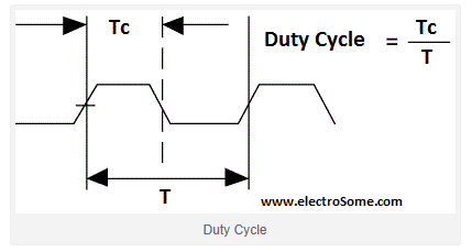

Duty Cycle
It is the ratio of time Tc during which the output is high to total time period T of the cycle.
Thus here, Duty Cycle = Toff/(Toff + Ton) when the output is taken from the collector of the transistor T.
