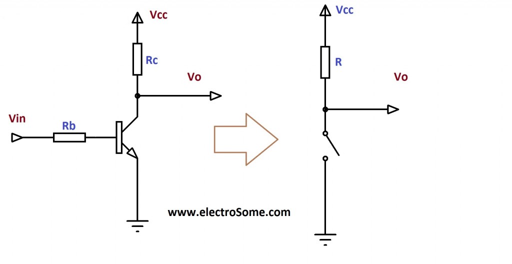

Circuit Diagram – Transistor as a Switch
From the above circuit we can see that the control input Vin is given to base through a current limiting resistor Rb and Rc is the collector resistor which limits the current through the transistor. In most cases output is taken from collector but in some cases load is connected in the place of Rc.

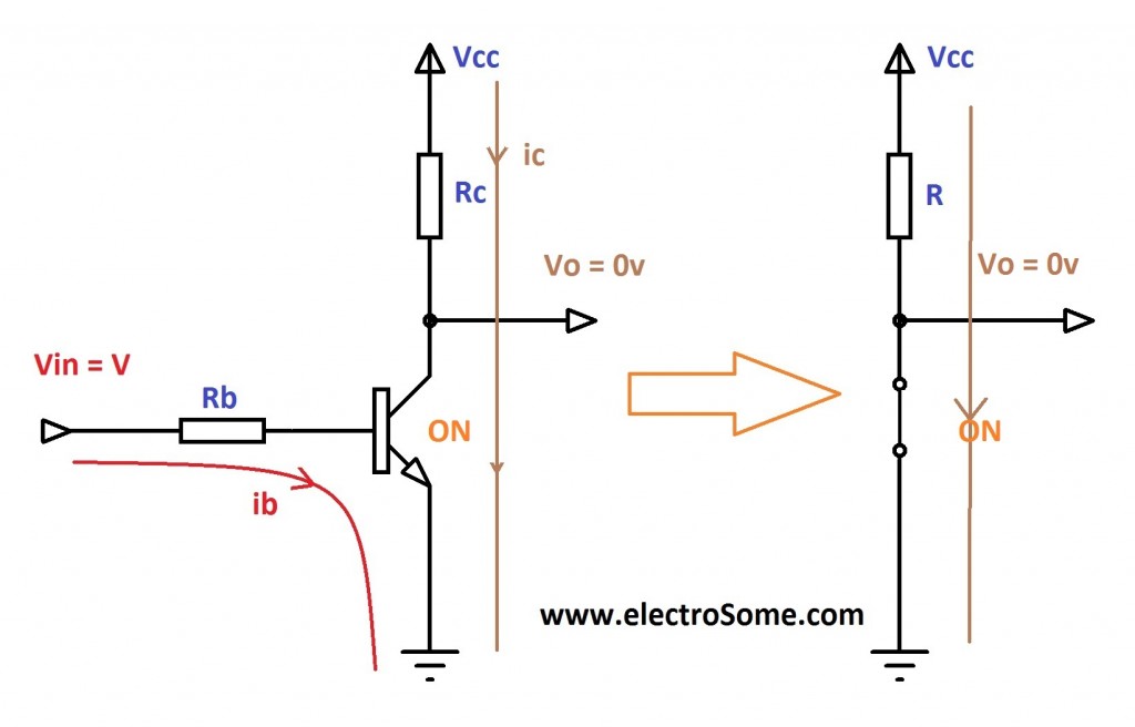

Transistor as a Switch – ON
Transistor will become ON ( saturation ) when a sufficient voltage V is given to input. During this condition the Collector Emitter voltage Vce will be approximately equal to zero, ie the transistor acts as a short circuit. For a silicon transistor it is equal to 0.3v. Thus collector current Ic = Vcc/Rc will flows.

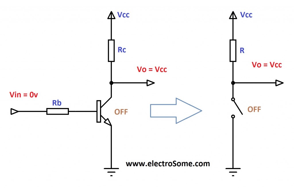

Transistor as a Switch – OFF
Transistor as a Switch OFF
Transistor will be in OFF ( cutoff ) when the input Vin equal to zero. During this state transistor acts as an open circuit and thus the entire voltage Vcc will be available at collector.

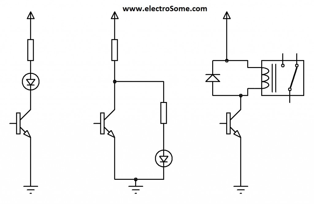

Different Ways of Connecting Loads
Load can be connected to transistor in different ways, some of them are shown below.
In the case of inductive loads such as Relay a freewheeling diode should be connected in parallel to it.
