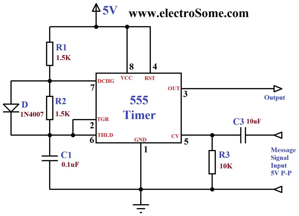

Circuit Diagram
8th and 1st pin of the 555 are used for giving power, Vcc and GND respectively. 4th pin is the Reset pin which is a active low input, since it is tied to Vcc. When the output is high, capacitor C1 charges to Vcc through R1 and D. When the output is low, capacitor discharges through resistor R2 and 7th of the IC. This charging and discharging time periods determines the time period of output. Message signal is fed to 5th (Control Voltage) pin of the IC through a coupling capacitor and the output can be taken from the 3ed pin of the IC.

Central frequency or Carrier frequency of the generated FM can be determined from the expression, fo = 1/(0.693RC), where R = R1 = R2 and C = C1.

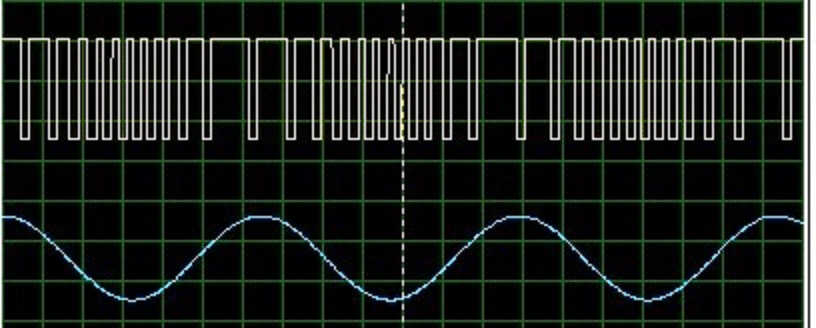

When an input voltage (say V) is given to Control Voltage pin, the upper and lower comparator reference changes to voltages V and V/2. So when the capacitor voltage becomes less than V/2, output becomes high and the capacitor starts charging to Vcc through resistor R1 and diode D. When the the capacitor voltage becomes greater than V, output becomes low and the capacitor starts discharging through resistor R2 and 7th pin of the IC. So the time period is proportional to the input voltage V. So as V increases, time period of the output wave increases and when V decreases time period of the output wave decreases.
Output

• fo = 1/(0.693RC), where R = R1 = R2 and C = C1
•Coupling capacitor C3 is designed in such a way that it can couple the input message signal.
