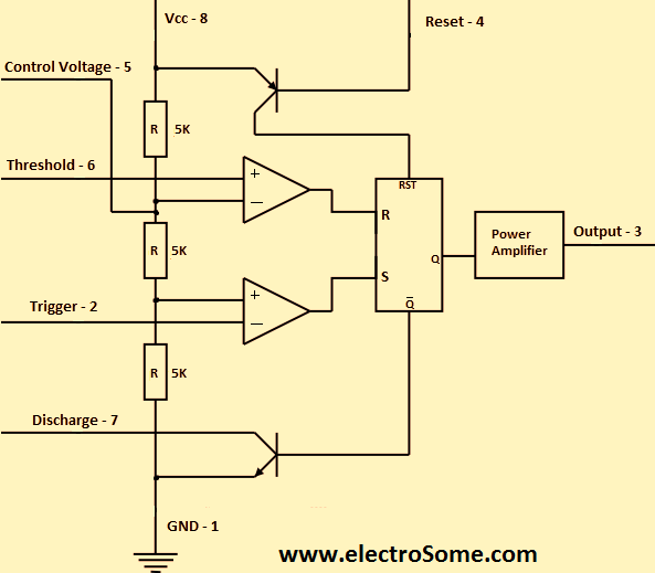

Internal Diagram of 555 Timer
From the above diagram we can find that the power supply to the timer can be given through pin 8 ( Vcc ) and pin 1 ( Gnd ). Vcc can be between +5v to 15v. Then we can find that a voltage divider is formed between Vcc and Gnd using three 5K? resistor. It is hypothesized that 555 got its name from these three 5K? resistors. Voltage at the junctions of these resistors will be 2/3 Vcc and 1/3 Vcc as all resistors are of same value which are used as the reference voltages of the comparators.
A comparator is a device which compares two voltage and indicate which one is larger. The trigger input of 555 (pin 2) is connected to the comparator with reference voltage 1/3 Vcc and the threshold input (pin 6) is connected to the comparator with reference voltage 2/3 Vcc. These reference voltages can be change using the Control Voltage Input (pin 5).
The output of comparators are directly given to the inputs of SR Flip Flop. Thus the output of the SR Flip Flop will be set according to the outputs of the comparator which in turn depends on the Trigger and Threshold inputs.

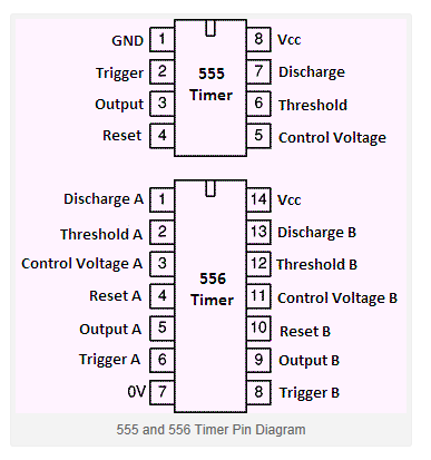

Pin Diagram
Pin Functions of 555 Timer
1. Ground
This is the ground pin or common pin of the IC. It should be connected to the negative terminal of the DC Power Supply.
2. Trigger
It is the pin connected to the inverting terminal of the lower comparator. As the name suggests it is used to trigger the timer. A negative trigger at this pin sets the flip flop. Precisely when the trigger voltage becomes less than Vt. Vt = 1/3 Vcc, When the Control Voltage (pin 5) is not used. Vt = 1/2 of the voltage at pin 5 when it is used.
3. Output
This is the output pin of the timer. It can source or sink 200 mA of current.
4. Reset
This pin is used to reset the timer. When the voltage at this pin becomes less than 0.7 V , the IC will reset and the output will be 0V. So in normal operations this pin will be tied to Vcc.
5. Control Voltage
This pin can be used to change the reference voltages of the comparators through this we can vary the timing.
6. Threshold
This pin resets the timer (makes output low) when the voltage given to it becomes greater than Vth provided the Trigger input remains HIGH. Vth = 2/3 Vcc when the Control Voltage is not using. Vth = Voltage given to Control Voltage when it is using.
7. Discharge
This pin is connected to the open collector of a transistor whose emitter is grounded and base is connected to compliment of output. So when the output is low, transistor becomes ON and collector becomes grounded. This pin is commonly used to Discharge the capacitor using for timing.
8. Vcc
This is the positive supply terminal of the IC. It can be connected to any voltage between 4.5 V through 15 V.

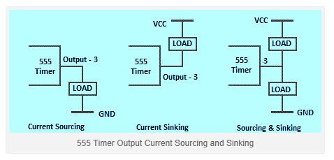

Using the Output of a 555 Timer
The output of 555 can be HIGH ( 5v) or LOW (0v ) at any time. Its output is compatible with TTL and can be directly connected to TTL IC’s.

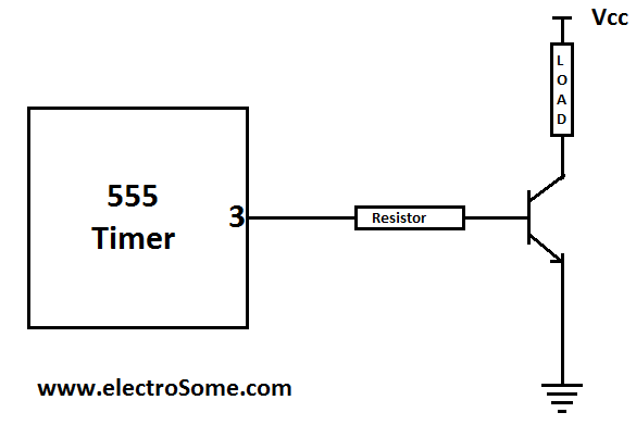

When the output of 555 is HIGH current is sourced from the IC and when the output is LOW 555 is sinking current. It can source or sink current up to 200mA. If the load requires more than 200mA we can connect an external driver transistor for that.
