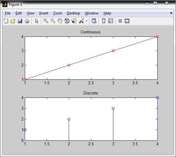

Plotting an Array of Data
x=[1 2 3 4];
subplot(2,1,1); # refer NOTE
plot(x,'ro-');
title('Continuous');
subplot(2,1,2);
stem(x);
title('Discrete');
Output :

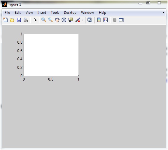

- subplot() - is a function MATLAB which allows us to draw 2 or more graphs simultaneously on a single figure window. The function breaks the figure into matrix specified by user and selects the corresponding axes for the current plot SYNTAX : subplot(m,n,p) – Divides the figure window into m x n matrix of small axes and selects the pth axes object for the current plot. eg : subplot (2,2,1) – divides the figure into a 2 x 2 matrix (4 equal parts) and selects 1st axes object.
suplot (2,2,1)
suplot (2,2,1)

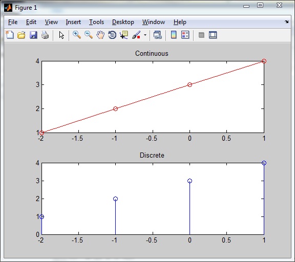

- The important point to be noted while dealing with the array data is MATLAB index starts with 1, ie by default MATLAB always assumes x(1) as the first element of the array [in above eg: x(1)=1]. So if we have to change the time index we have to define the range.
eg:
x=[1 2 3 4];
dtx=-2:1; #defining discrete time for x, from -2 to 1
subplot(2,1,1);
plot(dtx,x,'ro-');
subplot(2,1,2);
stem(dtx,x);
title('Discrete');
Output :
Plot of Continuous and Discrete signal with index changed

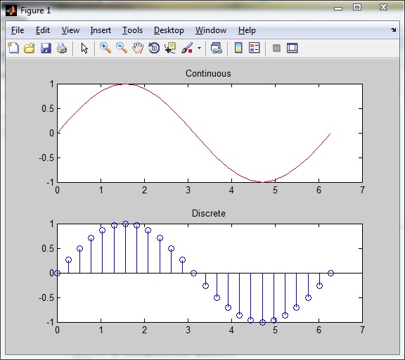

Plotting a Function
Now lets plot a function continuously and discretely. I’m going to plot a sine function
x=linspace(0,2*pi,25); # 0 to 2pi is divided in 25 equidistant points
y=sin(x);
subplot(2,1,1);
plot(x,y,'r');
subplot(2,1,2);
stem(x,y);
title('Discrete');
Output :
Sine wave plot
Sine wave plot

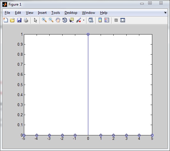

I. Impulse function
Impulse function given by
? (t) = { 1 for t=0 ; 0 otherwise }
n1=input('Lower limit')
n2=input('Upper limit')
x=n1:n2;
y=[x==0];
stem(x,y,);
Output :
Plot of Impulse Funtion<br />n1=-5 ; n2=5
n1=-5 ; n2=5

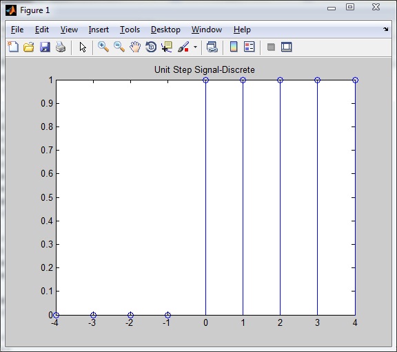

II. Unit Step Signal
u(t)={ 1 for t >=0 ; 0 for t< 0 }
Discrete
n1=input('Enter the lower limit');
n2=input('Enter the upper limit');
n=n1:n2;
x=[n>=0];
stem(n,x);
title('Unit Step Signal - Discrete');
Plot of Unit Step Signal – Discrete<br />n1= -4 ; n2 = 4
n1= -4 ; n2 = 4

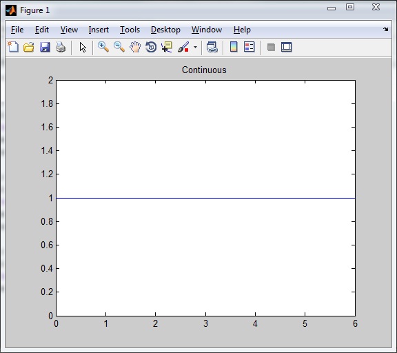

Continuous
n=input('Enter the upper limit');
t=0:n;
x=[t>=0];
plot(t,x);
Unit step signal – Continuous<br />n = 6
n = 6

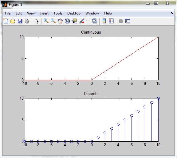

III. Unit Ramp Signal
r(t)={ t for t >= 0 ; 0 for t <0 }
Recall that ramp signal r(t)=t*u(t) where u(t) is unit step signal
n1=input('Enter lower limit');
n2=input('Enter upper limit');
n=n1:n2;
x=n.*[n>=0];
subplot(2,1,1);
plot(n,x,'r');
subplot(2,1,2);
stem(n,x,'b');
title('Discrete');
Output :
Unit Ramp Function<br />n1=-10 ; n2=10
Unit Ramp Function
n1=-10 ; n2=10

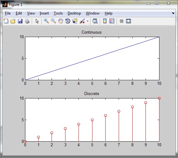

Shortcut method for Generating Ramp Signal
t=0:n;
subplot(2,1,1);
plot(t,t);
subplot(2,1,2);
stem(t,t);
title('Discrete');
Output :
Unit Ramp Function Shortcut Method with n=10

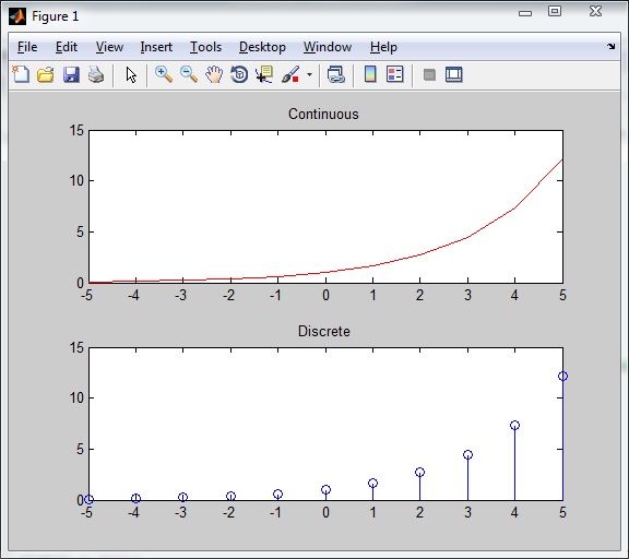

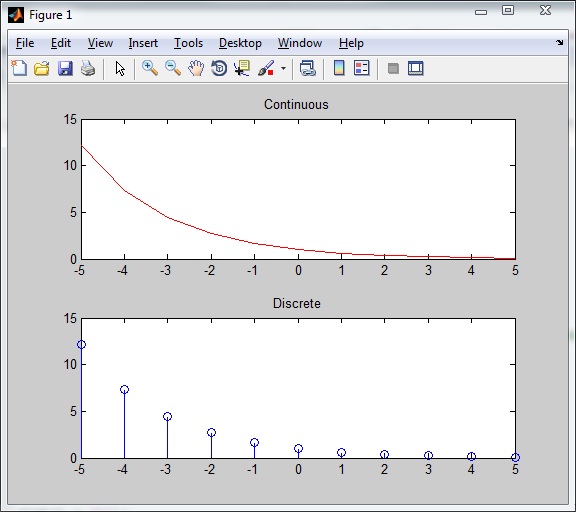

IV. Unit Exponential signal
x(t)= eat
t=n1 : n2;
a=input('Enter the value for a');
y=exp(a*t);  # exp() function in matlab SYNTAX : exp(a)n- returns the exponential factor of a
subplot(2,1,1);
plot(t,y,'r');
subplot(2,1,2);
stem(t,y,'b');
title('Discrete');
Output :
Exponentially Growing Signal<br />n1 = -5 ; n2= 5 ; a = 0.5
Exponentially Decaying Signal<br />n1 = -5 ; n2 = 5 ; a = -0.5
