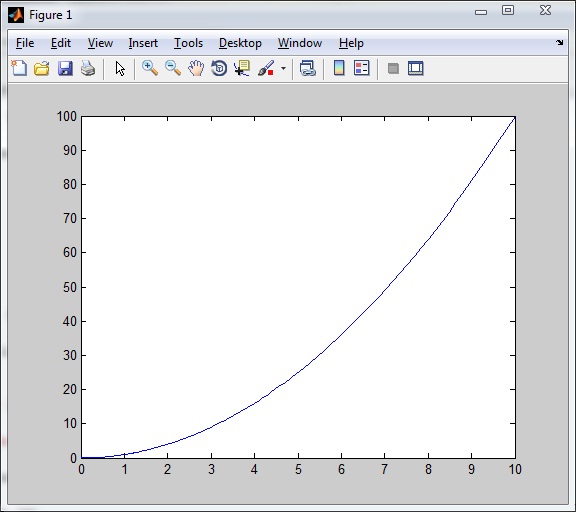

eg :
fplot( 'x.^2' , [0,10])
Output:
Output of fplot function in Matlab

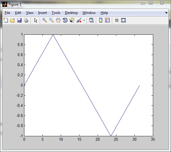

eg :
 x= linspace(0,10*pi,5); # linspace is not line specification it is used to generate linearly spaced vectors
y=sin (x);
plot(x,y)
Ouput :
Output of plot function in Matlab

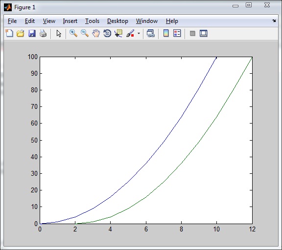

# For plotting 2 functions at a time
Syntax :poly(x1,y1,x2,y2)
eg:
 x=0:10;
y=x.^2;
z=2:12;
t=x.^2;
plot(x,y,z,t)
Output :
Output of plot function in Matlab – Plotting 2 Functions at a Time

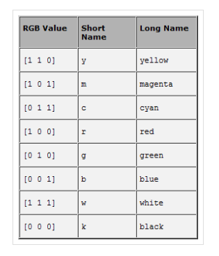

Colorspec is a method of specifying colors. There are 3 ways with which you can specify color
Color Specifications of plot funtion in Matlab

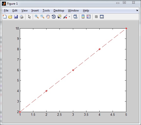

eg :
 x=1:5;
y=1:5;
z=x+y;
plot(z,'r*--')
Output:
Plotting Function in Red Dashed Line – Matlab

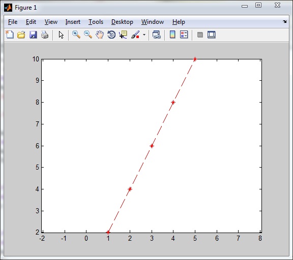

plot(z,'r*--')
axis equal
Output:
Plotting Function in Red Dashed Line with equal Axis – Matlab

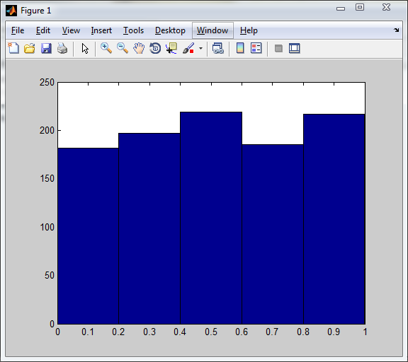

Histogram and Pie Chart
MATLAB also helps us to plot Histogram and Pie chart.
Histogram
hist() function helps us to plot the histogram .
SYNTAX:
1.n=hist(y) - Bins the elements in vector y into 10 equally spaced containers and returns the number of elements in each container as a row vector.
2.n=hist(y,x)- Where x is a vector, returns the distribution of y along length (x) bins with centers specified by x.
3.n=hist(y,nbins) – Here nbins is scalar and uses it as number of bins
eg :
  x=rand(1000,1); #rand function generates nxn matrix ; rand(m,n) generates mxn square matrix
fix(x);         # used to round it off to 0
hist(x,5)       # returns the distribution of x in 5 length bin;
Output:
Histogram usinghist function in Matlab

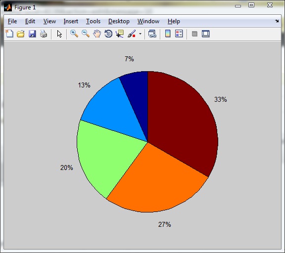

Piechart
pie() function helps us to plot the pie chart of our data.
SYNTAX:
1.pie(x)- draws a pie chart with the data in x.
2.pie(x,explode)-Offsets a slice from the pie.explode is a vector or matrix of zeroes and non zeroes corresponding to x.
eg:
 marks=[10,20,30,40,50]
pie(marks)
Output:
Pie Chart using pie function in Matlab

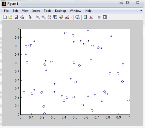

We can plot our data using scatter() function. In this data may be some points in a plane. So instead of using plot function we can directly use scatter function
SYNTAX:
1.scatter(x,y)-draws the markers in default size and color
2.scatter(x,y,s)-draws markers with specified sizewith single color.
3.scatter(….,markertype)-use the marker type instead of ’0?.
4.scatter(…, filled)- Fills the markers.
eg :
  x=rand(50,1);
y=rand(50,1);  # make sure that x and y equal length vectors
scatter(x,y)
Output:
Plotting Data using scatter function in Matlab

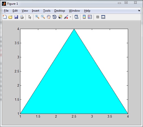

For plotting filled polygons we may use fill() function. The vertices are listed along with the color to be filled.
SYNTAX:
1.fill(x,y,)-Creates filled polygons from the data specified by x and y with color c.
2.fill(x1,y1,c1….xN,yN,cN)- specifies multiple 2-D filled areas
3.fill(x,y,colorspec)- fills 2-D polygons specified by X and Y with the color specified by colorspec explained in earlier section
eg:
  x=[1.0,4.0,2.5];
y=[1.0,1.0,4.0];
fill(x,y,'c')
Output:
Plotting Filled Polygons using fill function in Matlab

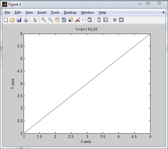

eg:
  x=1 : 5;
y=x+1;
plot(x,y)
xlabel('X axis ')
ylabel(' Y axis ')
title('Y=X+1 PLOT')
Output:
Labelling of a plot
Labelling of a plot
