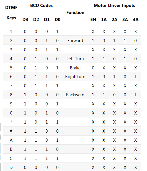

To activate the rover a call is made to the phone which is attached to the rover itself .The cell phone will be in auto answer mode .If any button is pressed during the call corresponding tone is heard on the other end .This tone is called Dual Tone Multi Frequency ( DTMF) tone .The tone is received by the phone attached to the rover .The received tone is fed onto the logic circuit (Decoder) which converts or decodes the tone corresponding to equivalent BCD codes .The output is fed onto the motor Which decides the motion of the rover according to output of logic circuit.
The logic relation between decoder and motor driver is as shown below :

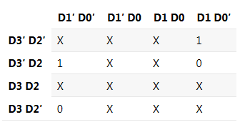

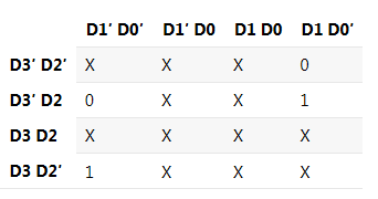

The logic relation for each input can be found out by solving the K-map as shown below :
1) EN (output enable ) =D0?
1 X X X
If we look the truth table its clear that the for operative’s signals the D0 data line is low ,which should be high and for brake it should below so that all functions stop and rover comes to rest .So the common enable of motor driver is given the signal D0?(compliment of D0).

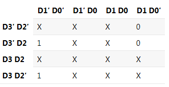

2) 1A=D1?
3) 2A= D1
The 2nd driver signal to the motor driver is the direct signal of date line D1.

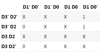

4) 3A=D2?D1+D2D1? ( D2 X-OR D1)
0 X X X
The 3rd driver signal to the motor is the XOR the data lines D2 and D1.

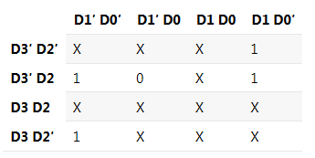

5) 4A=D2?D1?+D2D1 ( D2 X-NOR D1)
The 4th driver signal to the motor is the X-NOR of the data lines D2 and D1 or the complement of X-OR of D2 and D1.

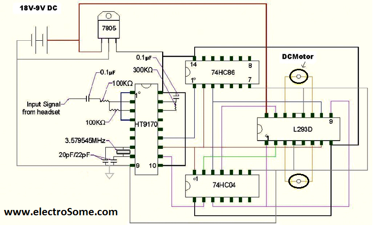

Circuit Diagram
This is the circuit diagram for the cellphone operated rover.The main parts are DTMF decoder,Logic circuits by IC’s and motor drivers. HT9170 IC is used as DTMFdecoder. It is a DTMF receiver integerated with digital decoders and bandsplit filter functions.All typeof HT9170 uses digital counting techniques to detect and decode 16 bit DTMF tone pairs to 4-bit code output.Highly accurate capacitor filters are employed to divide tone signals to high and low group signals.A built in dial tone rejection circuit is provided eliminate the need of prefiltering circuit.It decodes the DTMF tones to corresponding BCD codes.The IC 74HC04 is high speed CMOS hex Inverter (Not gates) and IC 74HC86 high speed CMOS quad XOR gates.These two IC’s forms the logic circuit between decoder and motor driver. Use high speed CMOS ICs only for this circuit other IC would require extra hardware like pull up resistors, etc. The L293D IC is comparator motor driver .It is a quad, high-current, half-H driver designed to provide bidirectional drive currents of up to 600 mA at voltages from 4.5V to 36V , consisting of of four drivers .It makes it easier to drive the DC motors .It is capable of handling the direction of motor easily according to the given logic inputs, this IC can handle up to 18V DC supply without any extra heat sink and 18V-30V with a heat sink. IC 7805 is used as voltage regulator which has 5V output.To interface DTMF signals in the circuit .Get a 3.5mm (or 2.5mm, whichever suits you) audio jack (male part) solder a long enough wire on to it and attach the other open end with the circuit .Connect the wire from the signal out pin(s) to the input end of the coupling capacitor in the circuit (where it reads input from headset), and ground wire of the jack to the circuit ground .For connecting the male jack use female jack in the phone .Don’t use any audio transmitter enhancement of cell phone.
