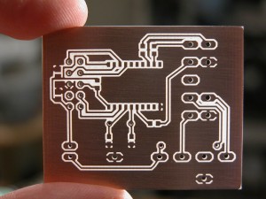

The easiest way to make a printed circuit board is to use a pre-printed template of the required circuit. Be sure that you transfer the layout to the board with the proper orientation. Reversing the layout makes a mirror-image of the board, leaving you with a pretty useless circuit board. If you reverse the layout, the connections for any integrated circuits are backwards; at best, the circuit just doesn’t work, and at worst, it can burn out components.

The etchant removes the copper, starting from the edges and areas close to resist. If you’ve gone through these steps, you’ve almost created your finished board. The etchant has completed etching when you can’t see any traces of exposed copper. Now you can drill the board and place the components in it.
