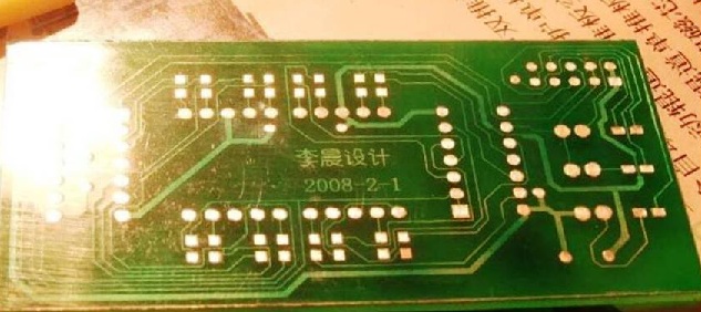

If you need to make professional quality PCBs with UV curable solder mask, here are the steps on how to do it. You can but most of these stuff from TRONIC.LK.

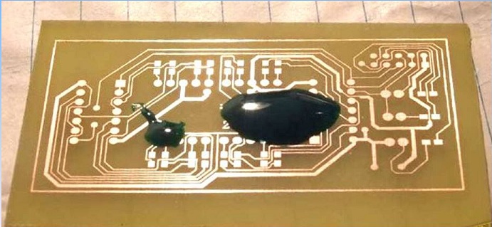

  1. Apply little paint on the PCB

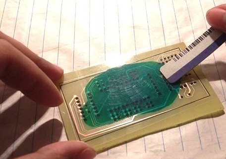

  2. Keep the printed transparent solder mask on it and spread it

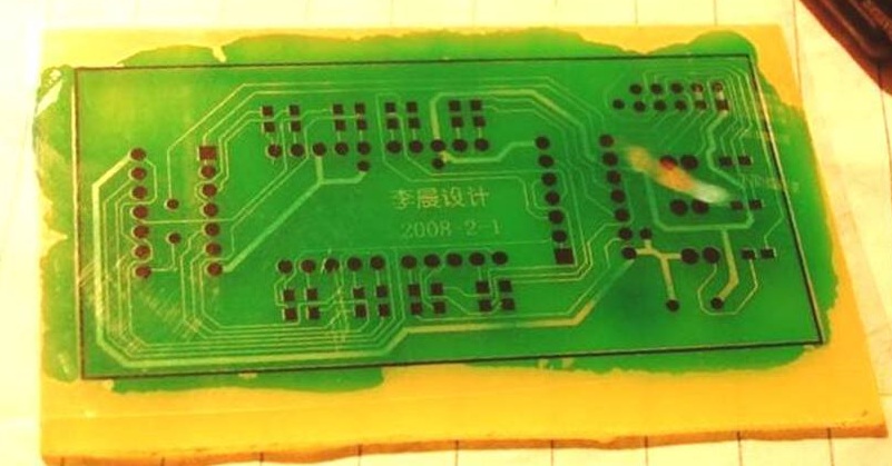

  3. Make sure the solder pads are perfectly aligned to the PCB

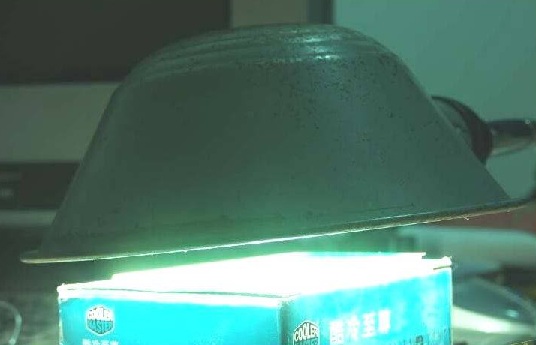

  4. Put it under strong UV light for 40 minutes (Florescent lights are okay)
  5. Remove the transparent sheet and wash away the extra paint using gasoline or oil base solvent
