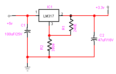

Making 3.3V from 5.0V using a LM317 Linear Regulator

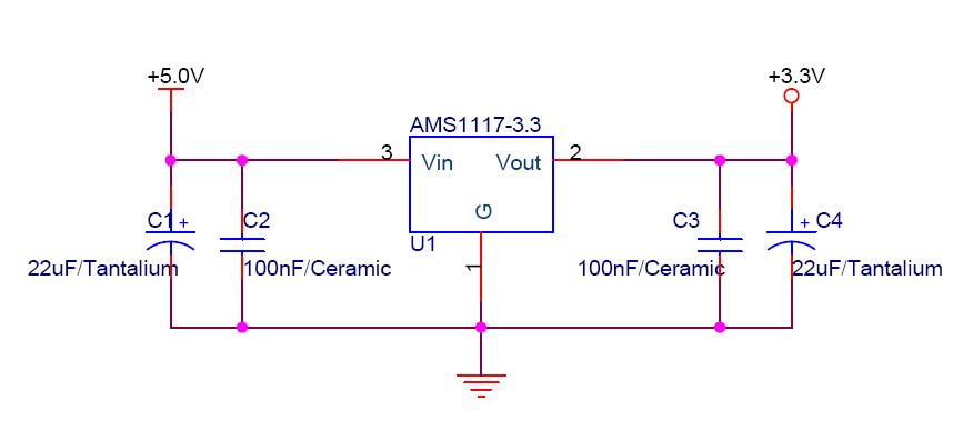

Making 3.3V from 5.0V using a AMS1117-3.3 Linear Regulator

I've noted that ceramic caps on both sides in figure 2 but they absent in design 1 with LM317.
Any idea why is that?

and in the design 1, I have another question , why we have to use 25v on c1? Due to defense against transients?
or we just use it to fiffle (x5) the lifetime of the capacitor? Since I can't read your mind I have these questions.
any why not ripple filter was invoked in design 1 there ?

Caps are for ripple rejection. yes. For more info, refer datasheets of both regulators.
