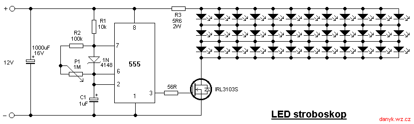

Dear friends.
I need Led strobe light cc't diagrame. It should can drive 50nos of 5mm white LED from 230v. If anyone have tested cc't, that's fine. Pls.post it that

Re: Need LED strobe light cc't diagrame
Post by Rksk » Mon Jul 16, 2012 5:46 pm
GihanAsanka wrote:Dear friends.
Which type of circuit, you are expecting? to drive strobe light using a circuit or to lightup 50LEDs from 230V?
Some diagrams may help you,
But my choise is drive it using a 4017 (knight rider) circuit powered by a transformer.
Post by SevenZero » Tue Jul 17, 2012 3:13 pm
Rksk's information is very good. Additionally have a look at following links too.
Single LED resistor calculator
LED array calculator for driving multiple LEDs

SevenZero
Posts: 263
Post by SevenZero » Tue Jul 17, 2012 8:58 pm
This is exactly the circuit diagram used to make the strobe in the youtube link.
If you can use a little AC-to-DC power supply, you can directly use this without any modification.
Post by GihanAsanka » Tue Jul 17, 2012 11:45 pm
Thanks.
But i try to use Rksk 1st circut diagrame (hand written one) + above circut final diagrame(ledstr.png). Will I have to do any modification using this cc't with 50nos white led with using 230v and without transformes?
