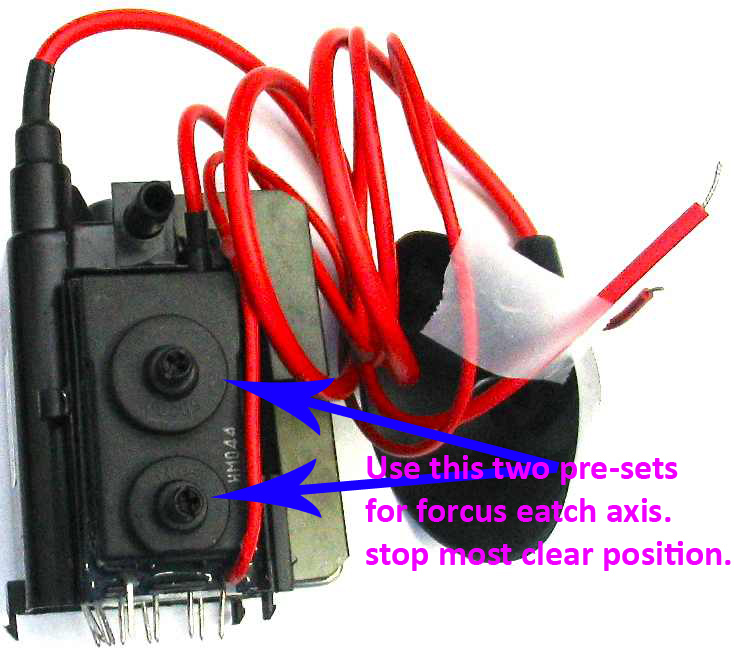

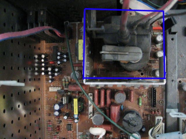

I found a new solution for CRT blur.it's very easy.But,BE CAREFUL.
Remove back casing and study about FBT placed.
Now get a insulated screwdriver and set pre-sets till most clear picture.
place a document with small letters on screen at this time.
you can get most clear position for each axis.and stop.
Use following images.
PLEASE BE CAREFUL
Place of FBT
Place of FBT

Vertical and Horizontal focusing pre-sets
FUH29A001 copy.jpg (184.24 KiB) Viewed 12829 times
