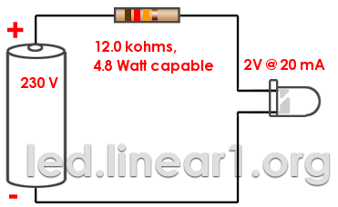

Here is a nice site that calculates the resistor required to connect an LED to a power source.
The simple calculation is R = (VS - VL) / I
Resister wattage: (VS - VL) x I
My Values were:
Source voltage: 230
diode forward voltage: 2*
diode forward current (mA): 20*
*See 5mm LED typical technical data
This was the result which is about right.
Have a look: http://led.linear1.org/1led.wiz
