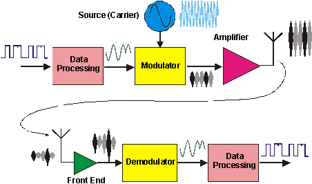

Basic Building Blocks
Frequency Source (Carrier)
In order to make the information signal (e.g. data) pass through the air, it must be modulated on to a carrier signal whose frequency is well suited to the propagation environment, conforms to the licensed operating bands, and is sufficiently stable to allow detection by a tuned receiver in the presence of interference.
Modulation
The method of imposing the information signal onto the carrier signal is termed modulation and must be accomplished cost effectively and accurately for maximum range and minimum interference.
Amplification
The amplifier is a key part of the transceiver, and must be efficient (dc power in to RF power out), low cost, non-polluting, and possibly linear. Output power is dictated by regulation, range requirement, battery life, cost and linearity considerations.
Antenna
The antenna is often the most poorly engineered part of a radio system. Good design will ensure maximum range, high amplifier efficiency (good matching), good selectivity, minimal pollution, good interference rejection, good sensitivity, reduced design headaches.
Reception
Key to the sensitivity, dynamic range and strong signal handling properties of the radio is the receiver ‘front end’. The main task is to boost weak wanted signals, often in the presence of strong unwanted signals whilst introducing minimal noise and distortion. In many cases, some selective filtering is required to assist this task.
Demodulation
The process of removing the information signal from the carrier is termed demodulation. The challenge is to design a circuit (or algorithm) that will achieve this task optimally in the presence of noise, interference and varying signal strength, frequency and phase, whilst being compact, power efficient and cheap.
Data Processing
Pre and post processing of the information signal is often an after thought for low power radio applications, usually implying some form of microprocessor or DSP engine with the presumed complexity, cost, power consumption and size penalties. The benefits of matched filtering, error detection and correction (coding), channel equalisation, etc, are however significant in terms of range, robust transmission, power conservation and data rate optimisation.

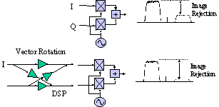

Vector Modulator
By applying the correct input to the two arms of the vector modulator, it is possible to impose any amplitude, frequency or phase shift directly onto a carrier in real time. If the carrier feeding the vector modulator is at the final output frequency for the radio, then the modulation is imposed directly onto the output signal in what is termed a direct conversion transmitter.
The function of the vector modulator can be realised in analogue or digital form. The digital form, whilst nearly perfect, has an upper frequency limit today of approx. 100MHz. The analogue form can be used with any frequency, (single chip devices now extend beyond 3GHz), but have imperfections in the mixing and summing process. These imperfections in practice result in an image of the modulation signal appearing at the output of the modulating circuit and residual carrier leakage.
In some cases it is possible to compensate for these imperfections by pre-distorting the input signal.

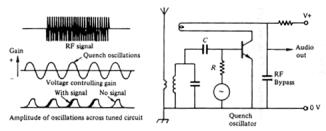

Super-Regenerative Receivers
The super-regenerative receiver actually makes use of the fact that when an amplifier is close to instability, the gain can be very large giving the potential for a highly sensitive receiver design. The trick with regenerative receivers is to maintain the receive chain on the point of instability. Typically this is achieved by repeatedly quenching the instability as it occurs and then allowing it to ‘grow’ back.
Whilst this approach yields a very low cost and simple receiver solution, it has poor selectivity as for other TRF designs, and is easily blocked by other signals. Further, radiation from the high gain oscillations on which the technique relies can often violate regulatory limits unless very careful design and screening is used.

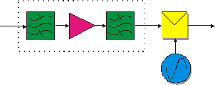

Because the input of the receiver is exposed to strong adjacent and out-of-band signals, linearity and intermodulation performance of the front-end amplifier and mixer stages must be carefully considered.

Image Reject Mixing: One further solution to the image problem is an image reject mixer. This device uses careful phase and gain balancing with a pair of mixers to remove the image by vector cancellation rather than filtering. Active image reject mixers are now appearing on the market and are used in some modern cellular handsets. Typical image rejection is however only about 20dB, which is sufficient to eliminate the noise doubling effect, or relax the specification on image reject filters, but not sufficient to suppress a strong signal if present in the image band.
