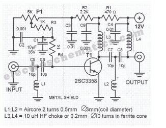

Please give me a circuit of High gain UHF TV booster To build one. Parts could be buy from Sri lanka.

Hi Friend ,
Here I am sending a circuit diagram that should work. I think you can buy all the parts of this circuit
from Sri Lanka. If you found any difficult to find the parts, please let me know. Then I will look for a supplier and
let you know.
This amplifier circuit is used to amplify TV signals in UHF range. It uses a low-noise transistor and gives 10 to 15 dB amplification in the frequency range from 400 MHz to 850 MHz.

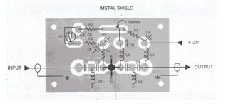

The transistor must be shielded from the input components and in constructing this circuit, the wirings must be as short as possible. For best results, the cable must be directly soldered to the PCB. The circuit should be installed near the antenna and housed in a water proofed case.
The power supply for this UHF TV antenna amplifier is fed through the cable by using a choke coil. To prevent the DC voltage from getting into the TV set, the coaxial cable must be coupled to the set through a small value capacitor.
To align the amplifier, just adjust P1 until the best reception is achieved. It means a collector current between 5 and 15 mA.
Shematic Diagram
PCB Layout
Component Placement

I tried a Booster with 2 C3358 Transistors I can watch channels but they are not clear. I need to watch SIrasa TV. I think it's at UHF channel 25. If you Have time Please Help me.
Re: High Gain UHF Booster
Post by Neo » Sun Apr 18, 2010 3:46 pm
I'm sure the one you made is not the one Magneto has added. Without circuit diagram, there is no possibility to help you.

  4. If you don't get any help, then submit your circuit diagram so someone will try to assist you
