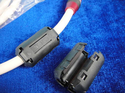

If you are using the PC power supply to power your circuit, the better switch mode power supplies are filtered to allow the AC in/DC out, but keep the RF contained within. Cheap power supplies often have RF suppression components left out to cut costs and in EU that's illegal. However if you are a victim of such a power supply, try adding a ferrite choke to power connection (as close to the device as possible). This will stop signals from getting in/out of the device by the power cable route.
