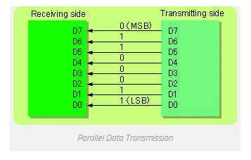

Parallel Transmission
In parallel communication an entire byte of data is transmitted at a time. That is each bit has dedicated line. Thus for 8-bit data transfer we need 8 dedicated lines as shown above.

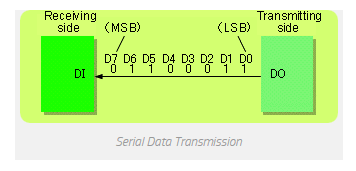

Serial Transmission
In Serial Transmission only one bit of a byte is transmitted at a time. There is only one communication line, thorough which bits are transmitted sequentially.

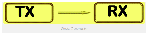

Simplex
In Simplex Transmission, data is transmitted only in one direction.

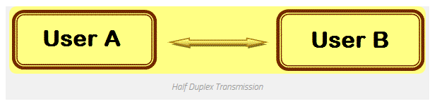

Half Duplex
In Half Duplex Transmission, data can be transmitted in both directions but to one side at a time.

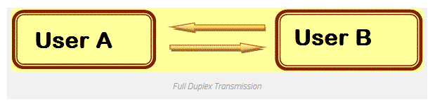

Full Duplex
In Full Duplex Transmission data can be transmitted simultaneously in two directions.

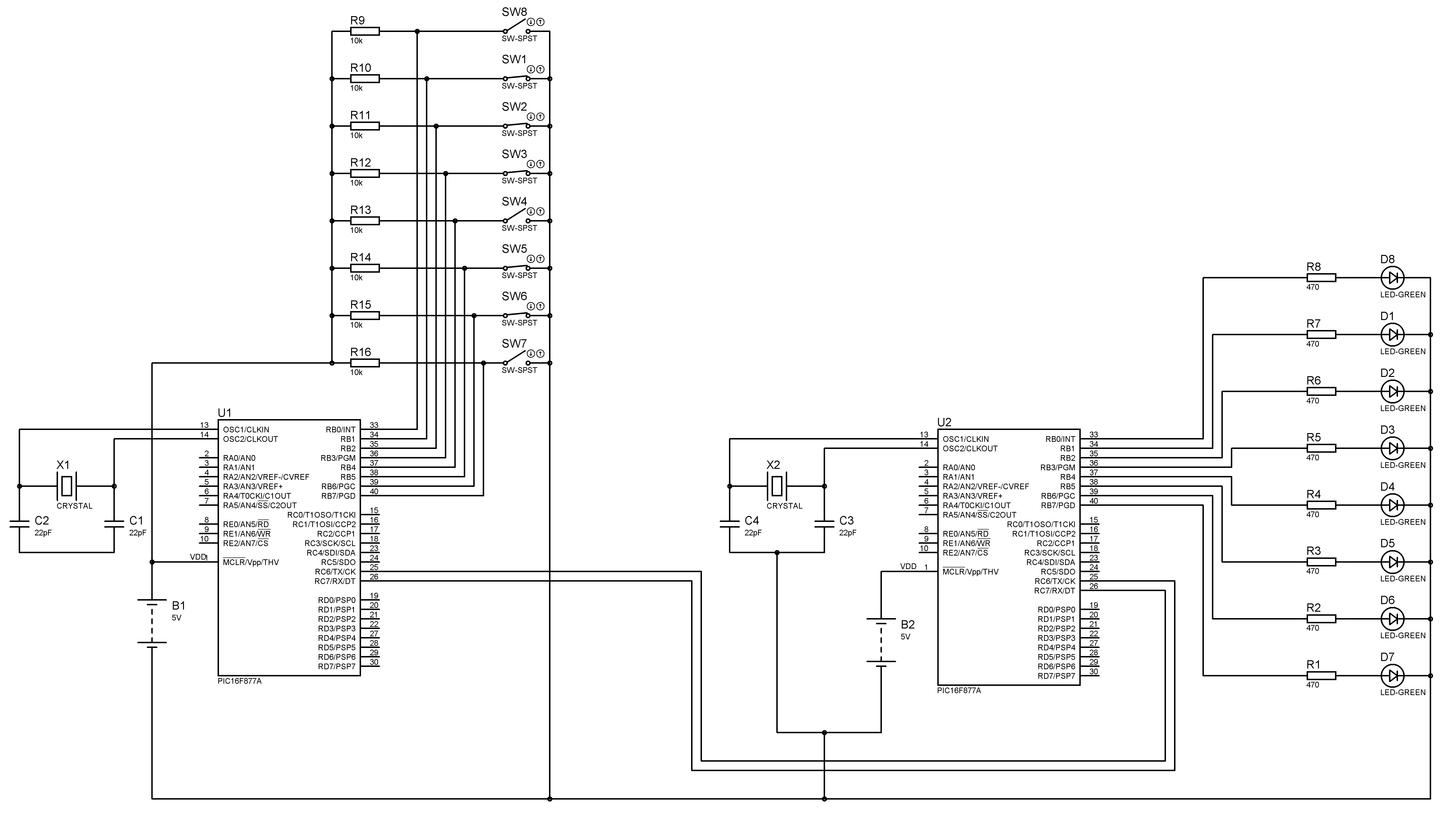

Circuit Diagram
PIC to PIC Communication using USART
The above circuit can demonstrate the PIC to PIC Communication using USART. Here we are using Asynchronous communication. The switch status read by the first PIC is transmitted to the second PIC and displayed using LED’s.
