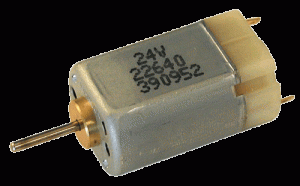

In some of your electronic projects you may want to control a DC Motor with Atmega32 Microcontroller. We can’t connect a DC Motor directly to a microcontroller due to following reasons.
?A microcontroller can’t supply the current required for the working of DC Motor. ATmega32 Microcontroller can source or sink currents up to 40mA but a DC Motor needs current very much more than that.
?The negative voltages created due to the back emf of the motor may affect the proper functioning of the microcontroller.
?You may need to control the direction of rotation of the motor by changing the polarity of the motor supply.
?The operating voltage of the DC Motor may be much higher than the operating voltage of the microcontroller.

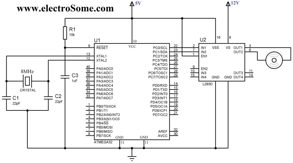

Circuit Diagram
Interfacing DC Motor with Atmega32 Microcontroller – Circuit Diagram
Motor Supply is given to the Vs pin of L293D and motor is connected to the first pair of drivers, which is enabled by connecting EN1 to logic HIGH. Vss pin is used to provide logic input to L293D. Control signals is given by using Atmega32 microcontroller which operates at 5V, hence Vss is connected to 5V.

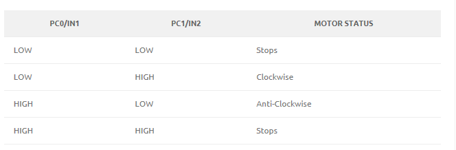

    PORTC = 0x03; //00000011
    _delay_ms(4000);
Control Signals and Motor Status
