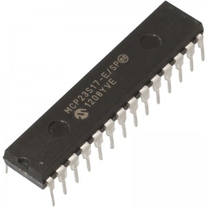

Usually a microcontroller comes with a limited number of IO ports called General Purpose Input Output (GPIO) ports. But some applications require more IO ports than that available on a microcontroller. In these cases we can use IO Port Expanders to increase the IO capability of a microcontroller. MCP23017 and MCP23S17 are two such 16 bit IO expander with Serial Interface manufactured by Microchip. MCP23017 uses high speed I2C interface while MCP23S17 used high speed SPI interface.
MCP23S17
MCP23S17

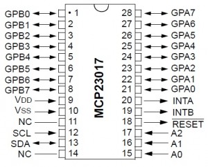

In this tutorial we will see how to expand IO ports of a PIC Microcontroller using MCP23S17. MikroC Pro for PIC Microcontroller provides built in libraries to communicate with MCP23S17 via SPI interface. We can connect up to eight MCP23S17 on a SPI Bus by using the three address pins present on it.

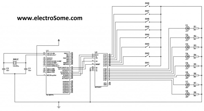

In this example project we use PIC 16F877A to demonstrate the working of MCP23S17. PORTA and PORTB of MCP23S17 is configured as Input and Output respectively. SPST switches are connected to PORTA along with the internal PULL UP of MCP23S17 and LEDs are connected to PORTB via current limiting resistors. Input to PORTA is the output to PORTB, so LEDs connected to PORTB will GLOW according the the status of SPST switches connected to PORTA.
Circuit Diagram – IO Port Expanding PIC Microcontroller
Expanding IO Ports of a PIC Microcontroller using MCP23S17
Note: VDD , VSS of the PIC Microcontroller and MCP23S17 are not shown in the circuit diagram. VDD should be connected to +5V and VSS to OV.
When a switch is ON corresponding LED will be OFF and when a switch is OFF corresponding LED will be ON. Since all the three address pin of MCP23S17 are grounded its address is 0.
