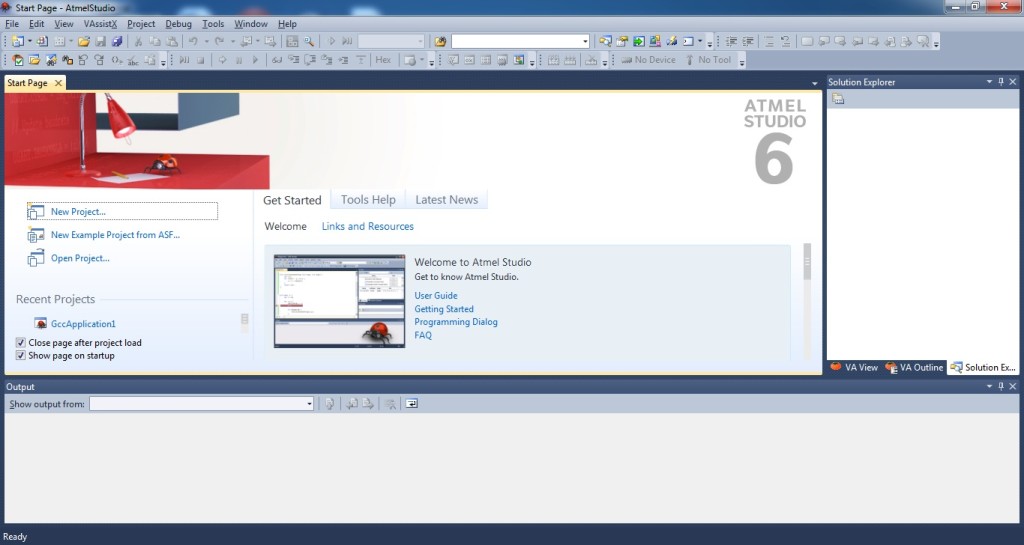

1. Download and Install Atmel Studio. You can download Atmel Studio from Atmel’s Website.
2. Open Atmel Studio
After Opening Atmel Studio

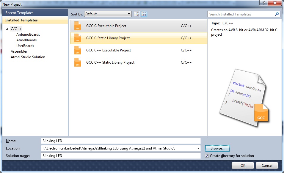

3. Select New Project
Opening New Project – Atmel Studio
4. Select GCC C Executable Project, give a project name, solution name, location in which project is to be saved and click OK.

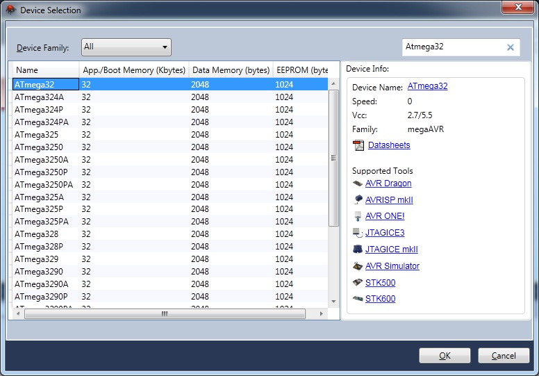

5. Selecting Microcontroller
Selecting Microcontroller – Atmel Studio
Choose the microcontroller that you are going to use, here we are using Atmega32. Then Click OK.

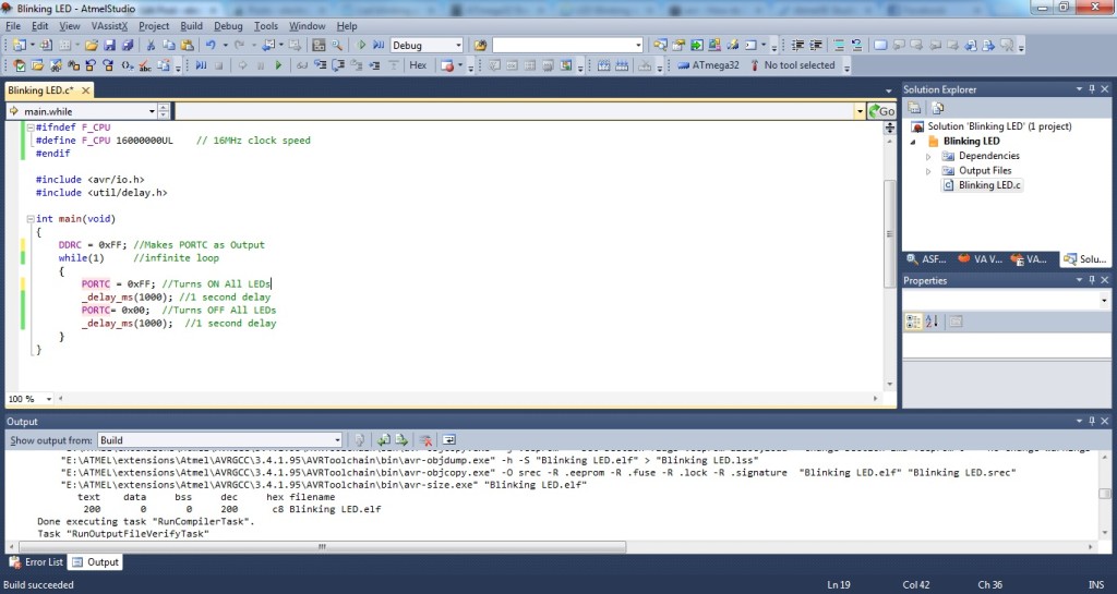

6. Enter the Program
Enter the Program – Atmel Studio
7. Then click on Build >> Build Solution or Press F7 to generate the hex file.

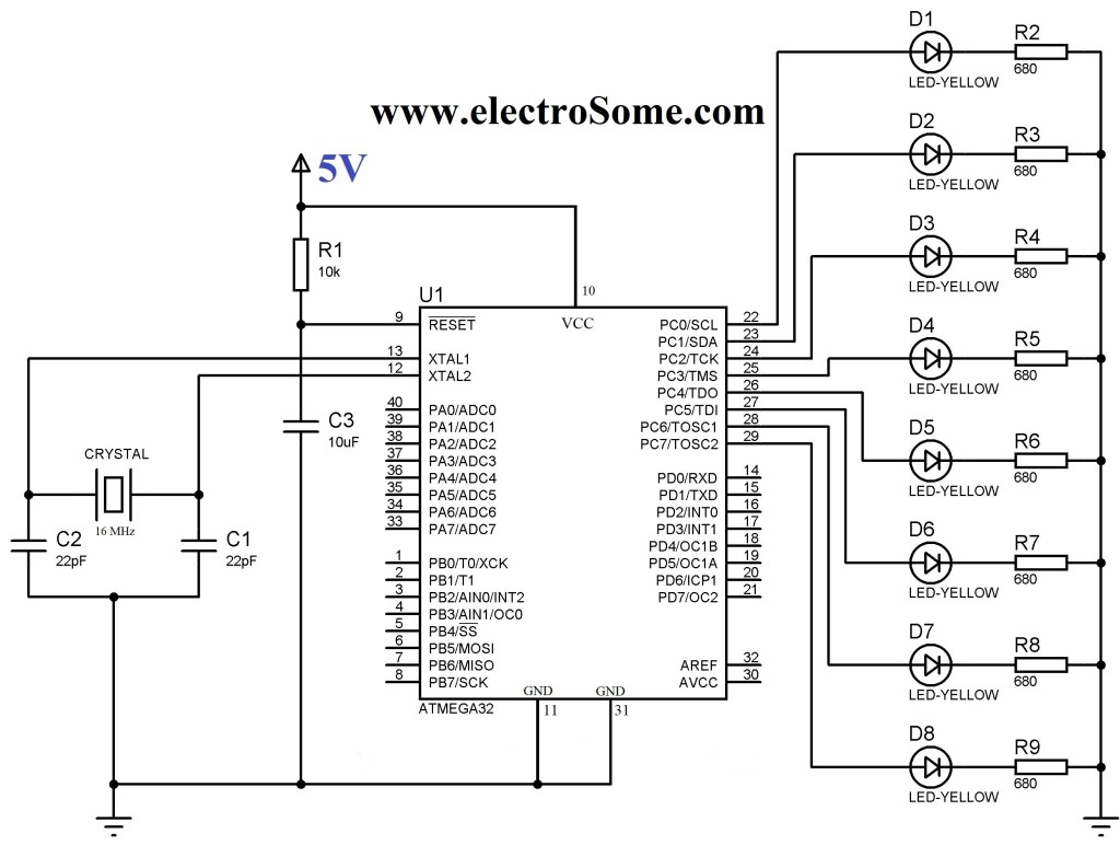

Circuit Diagram
Blinking LED using Atmega32 AVR Microcontroller and Atmel Studio
LEDs are connected to PORTC and current limiting resistors are used to limit current through them. 16 MHz crystal is used to provide clock for the Atmega32 microcontroller and 22pF capacitors are used to stabilize the operation of crystal. The 10µF capacitor and 10K? resistor is used to provide Power On Reset (POR) to the device. When the power is switched ON, voltage across capacitor will be zero so the device resets (since reset is active low), then the capacitor charges to VCC and the reset will be disabled. 30th pin (AVCC) of Atmega32 should be connected to VCC if you are using PORTA, since it is the supply voltage pin for PORT A.
Atmel Studio C Program
#ifndef F_CPU
#define F_CPU 16000000UL // 16 MHz clock speed
#endif
#include <avr/io.h>
#include <util/delay.h>
int main(void)
  DDRC = 0xFF; //Nakes PORTC as Output
  while(1) //infinite loop
    PORTC = 0xFF; //Turns ON All LEDs
    _delay_ms(1000); //1 second delay
    PORTC= 0x00; //Turns OFF All LEDs
- DDRC = 0xFF makes all pins on PORTC as output pins
- PORTC = 0xFF makes all pins on PORTC Logic High (5V)
- PORTC = 0×00 makes all pins on PORTC Logic Low (0V)
- _delay_ms(1000) provides 1000 milliseconds delay.
- while(1) makes an infinite loop

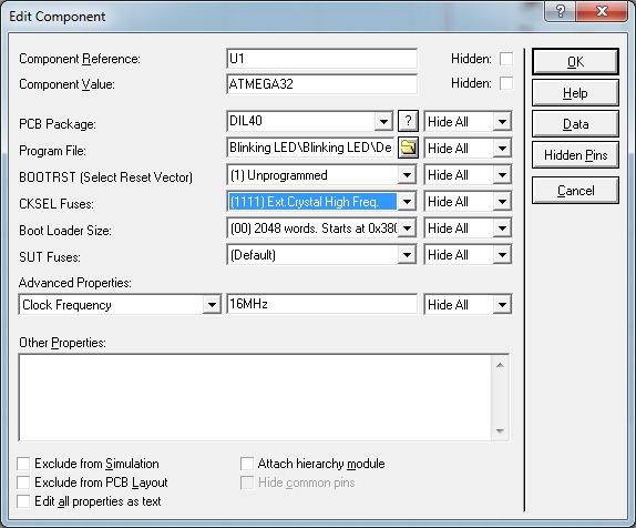

Proteus Simulation
If you haven’t yet started with PROTEUS. Draw the above circuit in PROTEUS and make following setting on the properties of Atmega32.
Atmega32 – Proteus Settings
Don’t forget to set the clock frequency to 16 MHz.
