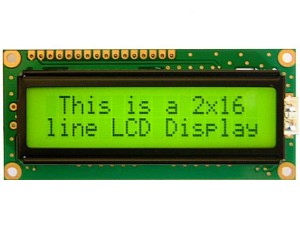

As we all know LCD (Liquid Crystal Display) is an electronic display which is commonly used nowadays in applications such as calculators, laptops, tablets, mobile phones etc. 16×2 character LCD module is a very basic module which is commonly used by electronic hobbyists and is used in many electronic devices and project. It can display 2 lines of 16 character and each character is displayed using 5×7 or 5×10 pixel matrix.
16×2 Character LCD
16×2 Character LCD

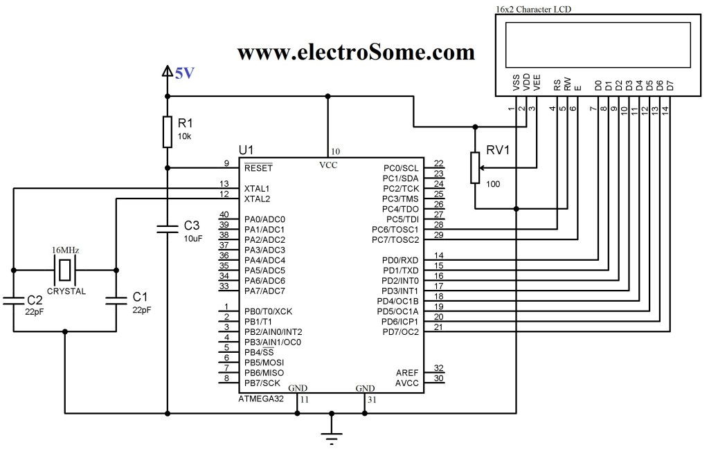

8 Bit Mode Interfacing
Circuit Diagram
Interfacing LCD with Atmega32 Microcontroller 8 Bit Mode
Atmel Studio C Code
#ifndef F_CPU
#define F_CPU 16000000UL // 16 MHz clock speed
#endif
#define D0 eS_PORTD0
#define D1 eS_PORTD1
#define D2 eS_PORTD2
#define D3 eS_PORTD3
#define D4 eS_PORTD4
#define D5 eS_PORTD5
#define D6 eS_PORTD6
#define D7 eS_PORTD7
#define RS eS_PORTC6
#define EN eS_PORTC7
#include <avr/io.h>
#include <util/delay.h>
#include "lcd.h" //Can be download from the bottom of this article
int main(void)
  DDRD = 0xFF;
  DDRC = 0xFF;
  int i;
  Lcd8_Init();
  while(1)
    Lcd8_Set_Cursor(1,1);
    Lcd8_Write_String("electroSome LCD Hello World");
    for(i=0;i<15;i++)
      _delay_ms(500);
      Lcd8_Shift_Left();
    for(i=0;i<15;i++)
      _delay_ms(500);
      Lcd8_Shift_Right();
    Lcd8_Clear();
    Lcd8_Write_Char('e');
    Lcd8_Write_Char('S');
    _delay_ms(2000);

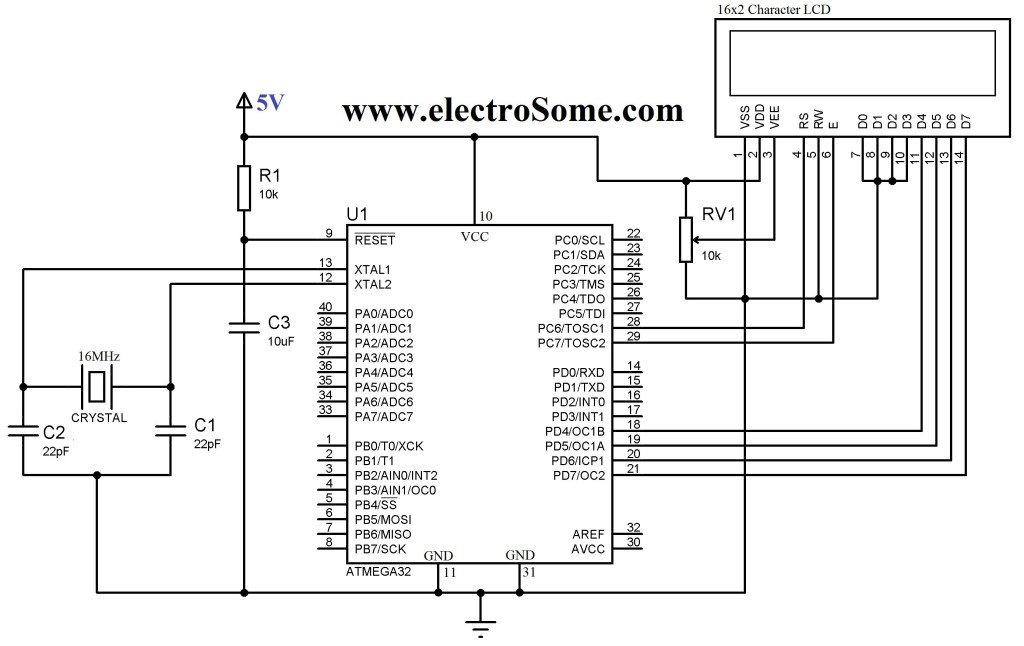

4 Bit Mode Interfacing
Circuit Diagram
Interfacing LCD with Atmega32 Microcontroller 4 Bit Mode
Atmel Studio C Code
#ifndef F_CPU
#endif
#include <avr/io.h>
int main(void)
  DDRD = 0xFF;
  DDRC = 0xFF;
  int i;
  Lcd4_Init();
  while(1)
    Lcd4_Set_Cursor(1,1);
    Lcd4_Write_String("electroSome LCD Hello World");
    for(i=0;i<15;i++)
      _delay_ms(500);
      Lcd4_Shift_Left();
    for(i=0;i<15;i++)
      _delay_ms(500);
      Lcd4_Shift_Right();
    Lcd4_Clear();
    Lcd4_Set_Cursor(2,1);
    Lcd4_Write_Char('e');
    Lcd4_Write_Char('S');
    _delay_ms(2000);
