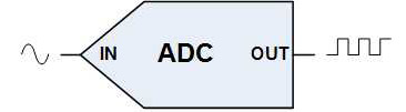

Analog to Digital Converter (ADC) is a device that converts an analog quantity (continuous voltage) to discrete digital values. This is very useful when we want to do some processing on physical quantities, which are normally analog in nature. Most of the PIC Microcontrollers have built in ADC Module. Here we are using PIC 16F877A for demonstrating the working.

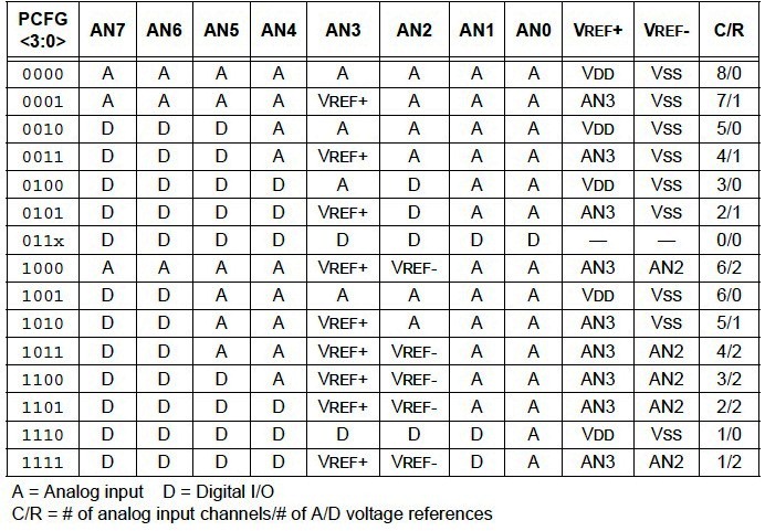

- PCFG3 – PCFG0 are the A/D Port Configuration Control bits. Each pin amoung AN0 – AN7 is configured as analog, digital or reference voltage inputs according to the status of these configuration bits as given below.
PIC ADC Port Configuration Bits
Note : TRIS Registers of Analog inputs must be configured as input for the proper operation.

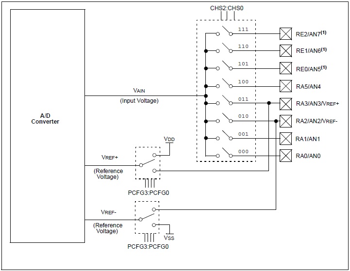

ADC Block Diagram
ADC Module Block Diagram – PIC16F877A

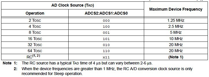

Selection of A/D Conversion Clock
The time for A/D Conversion per bit is defined as TAD and it requires minimum 12TAD to generate the 10-bit result. The time TAD is determined by the A/D Conversion Clock which is software selectable to following options.
- 2 TOSC
- 4 TOSC
- 8 TOSC
- 16 TOSC
- 32 TOSC
- 64 TOSC
- Internal RC oscillator of ADC Module
TOSC is the time period of the device clock usually provided by the crystal oscillator.
Care should be taken while selecting the A/D Conversion Clock, such that the clock should provide the minimum TAD (1.6?S) required for the correct A/D Conversion. So refer the following table before setting the ADC clock.
ADC Clock Selection Table – PIC 16F877A

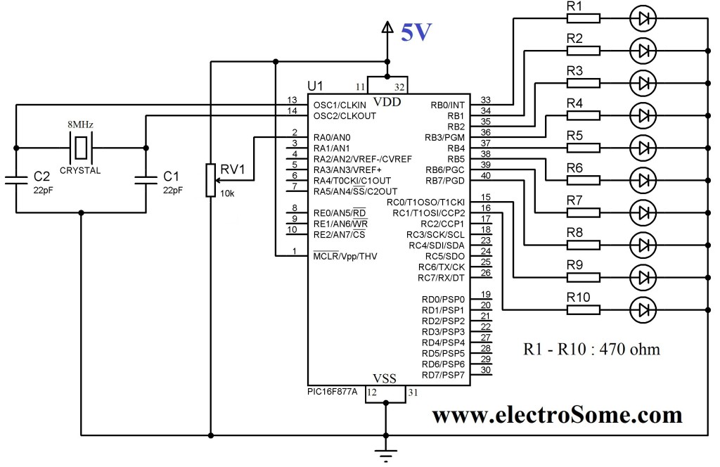

Circuit Diagram
Using Internal ADC Module of PIC Microcontroller
The reference voltages of ADC is set to VDD (5V) and VSS (GND) though software (code given below). Analog input is given to Channel 0 using a potentiometer, thus we can vary the ADC input voltage from VSS to VDD. The 10-bit result of ADC is displayed using 10 LEDs, and 470? resistors are used to limit current through them.
